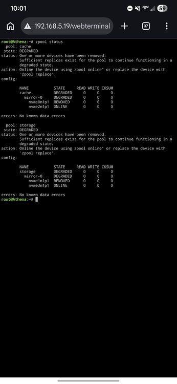

I keep having an issue with my storage and cache pools where one of the nvme drop connection while the other stays running. It kept happening when I was running a btrfs pools so I switched to zfs and its still happening. I have no idea what to do at this point, the drive in zfs shows that its missing but it doesn't have any errors.
athena-syslog-20260309-0207.zip
Mar 6 19:13:28 Athena kernel: nvme nvme0: I/O tag 411 (e19b) opcode 0x1 (I/O Cmd) QID 11 timeout, aborting req_op:WRITE(1) size:8192
Mar 6 19:13:45 Athena kernel: nvme nvme0: I/O tag 412 (d19c) opcode 0x1 (I/O Cmd) QID 11 timeout, aborting req_op:WRITE(1) size:12288
Mar 6 19:13:56 Athena kernel: nvme nvme0: I/O tag 4 (2004) opcode 0x6 (Admin Cmd) QID 0 timeout, reset controller
Mar 6 19:15:19 Athena kernel: nvme nvme0: Device not ready; aborting reset, CSTS=0x1
Mar 6 19:15:19 Athena kernel: nvme nvme0: Abort status: 0x371
Mar 6 19:15:39 Athena kernel: nvme nvme0: Device not ready; aborting reset, CSTS=0x1
Mar 6 19:15:39 Athena kernel: nvme nvme0: Disabling device after reset failure: -19

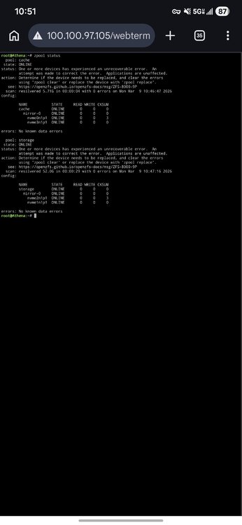

Thanks, I figured it wasn't an fs specific issue since its happened with both, I just wanted to make sure that I was using the best file system for my use case. I added that line to my boot options and did a shutdown and it brought the drives back. I've attached a screenshot below, I ran a new zpool status and the drive that dropped in both pools have 3 check sum errors, but it says that a scrub was run with no errors. Is there anything else I have to do for the check sum errors or just clear the errors from the pools?
Just hit CLEAR
