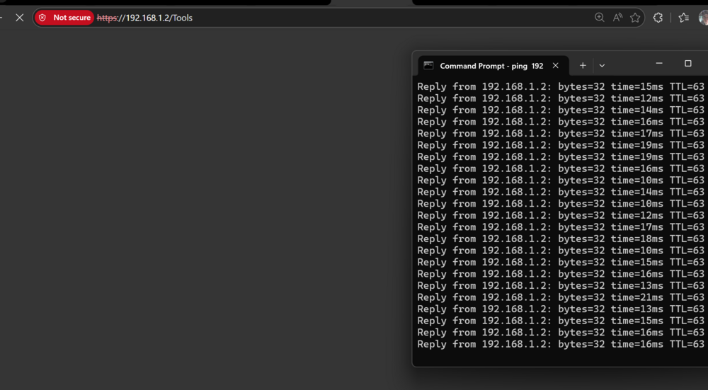

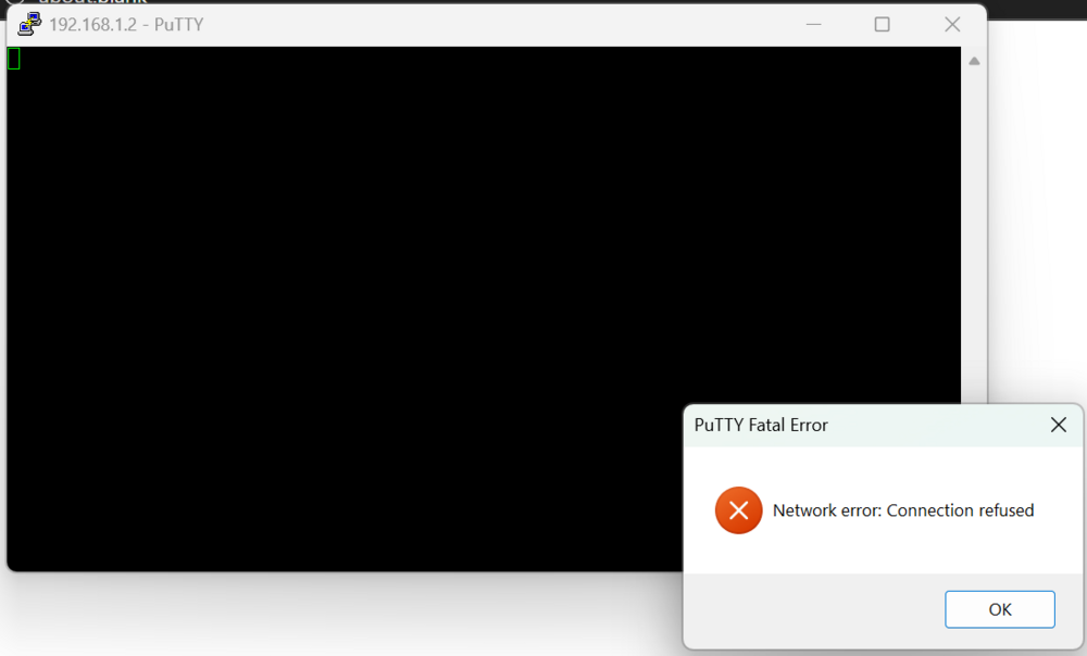

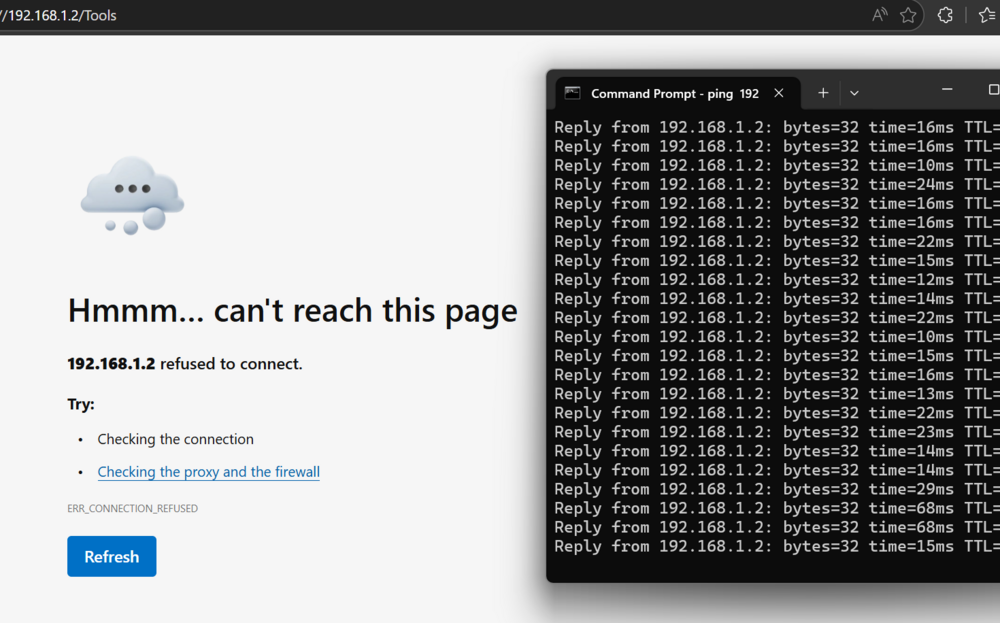

I have recently had some issues with shares breaking. I initially noticed this because I use uptimekuma to keep track of my services. My ping on my unraid server is fine, but port 445 check with TCP to check the shares has been going up and down. I Keep seeing this:
But even when its down sometimes I can still reach my shares.

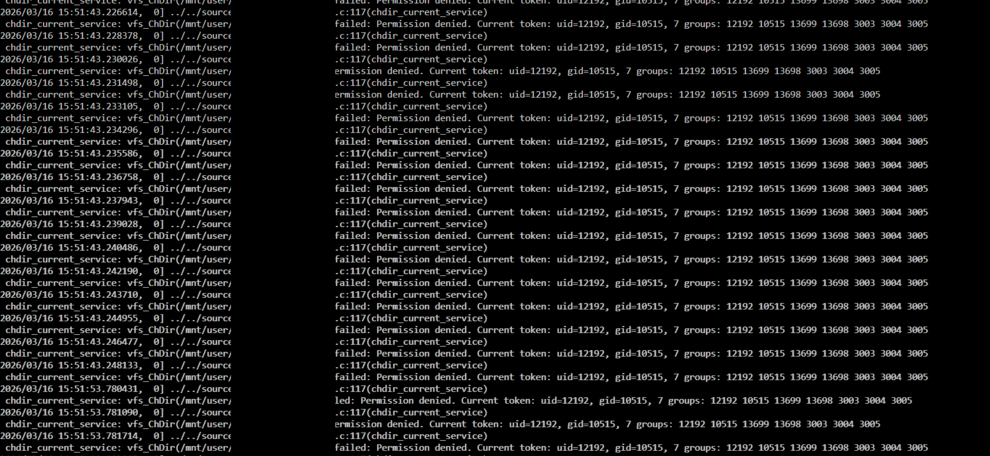

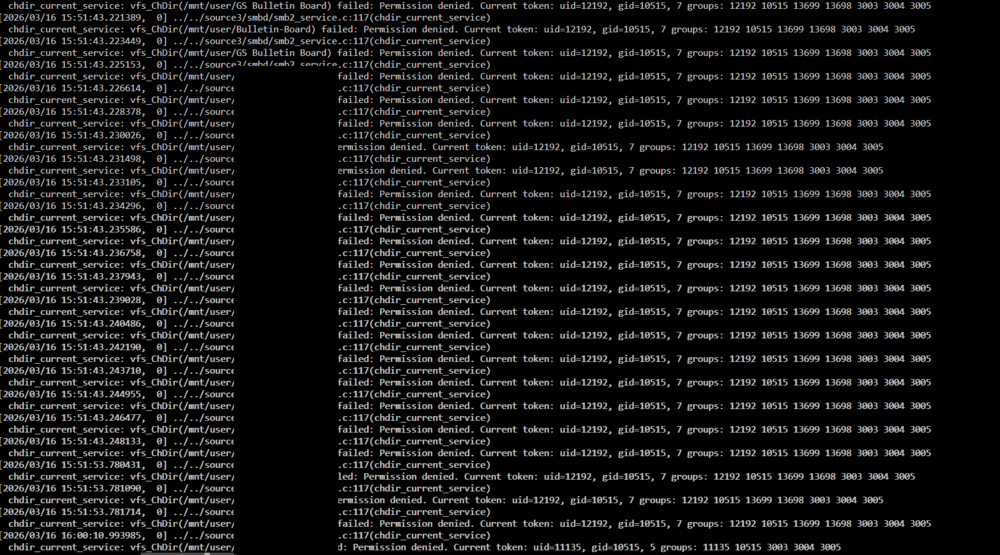

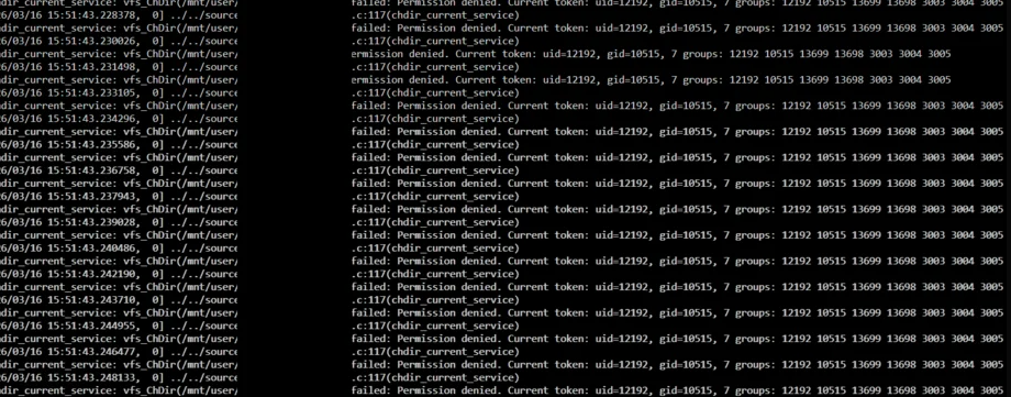

In my syslogs I see this error over and over again, with differeht share names:
Mar 16 09:50:50 Tower smbd[2008201]: chdir_current_service: vfs_ChDir(/mnt/user/SHARENAME) failed: Permission denied. Current token: uid=12192, gid=10515, 7 groups: 12192 10515 13699 13698 3003 3004 3005 Mar 16 09:50:50 Tower smbd[2008201]: [2026/03/16 09:50:50.237822, 0] ../../source3/smbd/smb2_service.c:117(chdir_current_service)
and i see these errors with a few other shares as well.

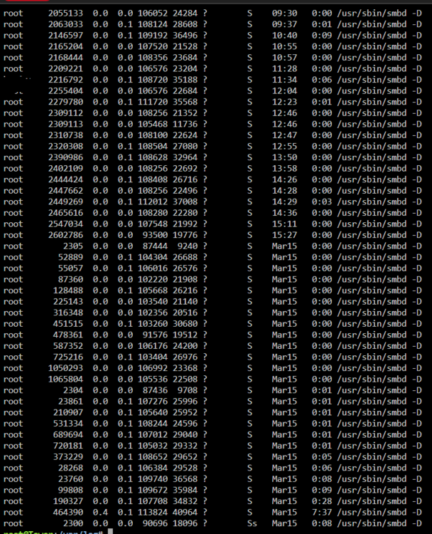

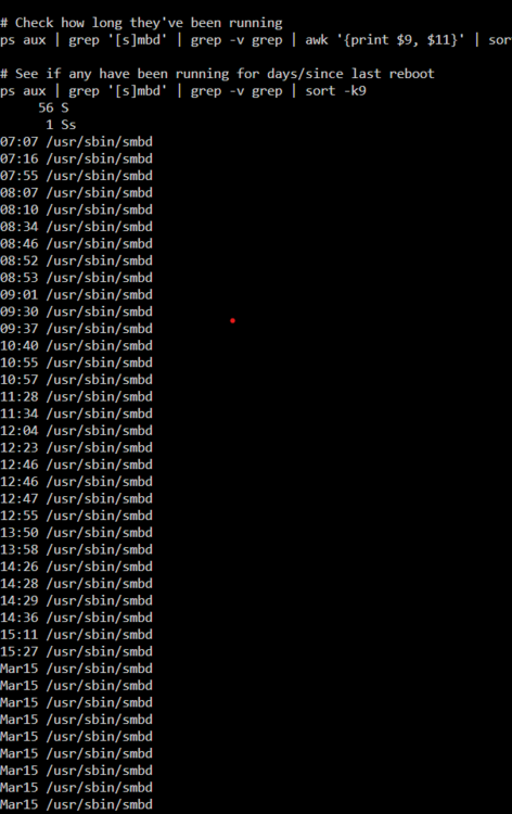

AI had me do some checks. It had me check my processes and how long they have been running:
(a few were skipped between screenshots)
and then it had me check if "idmap cache has a stale or inconsistent entry, or winbind is being queried with a local UID and can't map it back to a SID cleanly under load."
and also had me check if Samba/Winbind credential caching timeout issue.
ps aux | grep smbd | wc -l ps aux | grep smbd | head -50

This is what AI had concluded:
##################ai copy paste starts here######################
Now we have everything we need. The fix is straightforward — you need to add deadtime and a winbind credentials cache timeout to smb-extra.conf, which is the correct place to put persistent custom config on Unraid (it survives reboots, unlike smb.conf which gets regenerated).
A few observations from the full picture first:

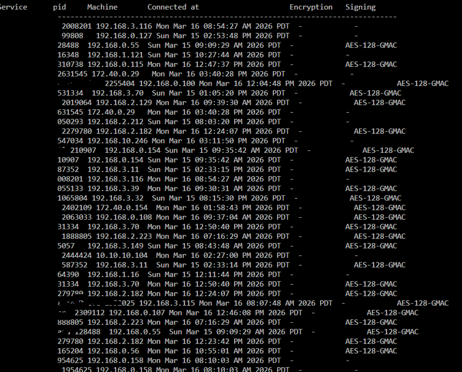

  • 59 smbd processes but only ~37 active sessions in smbstatus — so there are already ~20 orphaned processes accumulating
  • PID 464390 (SOMEUSERNAME from 192.168.1.16) has been running since Mar 15 and has consumed 7 minutes 36 seconds of CPU — that's the heaviest session by far and likely your ReportServer automation
  • The ANOTHERUSERNAME user connecting from 172.40.1.135 is coming in from what looks like a different subnet (Starlink/off-site?) — that's worth noting
  • No deadtime is set anywhere in smb.conf, confirming idle sessions never expire
The fix — add to /boot/config/smb-extra.conf:
bash
cat >> /boot/config/smb-extra.conf << 'EOF'
# Kill idle smbd processes after 15 minutes of no activity
deadtime = 15
# How long winbind caches credentials (seconds) - reduces DC hammering
winbind cache time = 300
# Ensure winbind refreshes group membership periodically
winbind offline logon = yes
# Prevent runaway smbd process accumulation
max smbd processes = 200
EOF
Then verify it looks right:
bash
cat /boot/config/smb-extra.conf
Then test the config is valid and reload:
bash
testparm -s 2>/dev/null | grep -E "deadtime|winbind cache|max smbd"
/etc/rc.d/rc.samba reload
After the reload, the existing 59 processes will persist until their clients disconnect or hit the new deadtime, but no new orphans will accumulate. Within an hour you should see the count drop significantly, and the intermittent WBC_ERR_DOMAIN_NOT_FOUND errors should stop.
The remaining issue to address separately: the XX user failing on YY/YYYYY is a legitimate missing group membership — if VV should have access, add unraid-YYYYY to that user in Unraid's user management GUI. Same applies to any other shares where the permission denials are expected vs. accidental.

also, one last thing, when i do a cat log.smbd all i see is this over and over for many different shares.:

the system monitoring may be causing ghost / cashed session to reactive adn given the other data
this looks like smb connections and reconencitons due to whats singed and currently connected to the system.

What your screenshot shows is a very specific Samba failure pattern that happens when an SMB client session still exists but the filesystem permissions or mount state underneath the share has changed.
The repeating error line is the key:
vfs_ChDir(/mnt/user/... )
chdir_current_service: failed: Permission denied.
Current token: uid=12192, gid=10515, 7 groups: ...
That tells us several important things.
What the log actually means
Samba is trying to switch the working directory of an already-connected client session.
Internally Samba does:
chdir("/mnt/user/<share>/<path>")
But the UNIX permissions for the UID/GID token Samba is using no longer allow access.
his happens in Unraid most often when one of these occurs:
Cached SMB sessions after permission changes
Example sequence:
  1. Windows client connects to share
  2. You run Docker/Unraid tools that change UID/GID
  3. Existing SMB session still uses old idmap token
  4. Next filesystem access → Permission denied
The Samba session keeps retrying → you get spam like your screenshot.
but this is and assumption. diagnostic file would help.

smbstatus
Look for:
PID     Username     Group      Machine
and
Service      pid     machine
If you see the same client repeatedly accessing the share → that's your spam source.
Example sequence:

smbstatus
Look for:
and
Service      pid     machine

I ran smbstatus and did not see anything out of the ordinary. I seen a single user logging into several shares from 7 different IPs which is 100% normal and expected. Several other users also logging in from single IPs to their own shares as well as shared shares.
A few other things. Whenever I have a management session open it stops responding every once and a while and I need to refresh. If i have the web console open it will close on me randomly... but ping never times out at all... image.png
after refreshing several times it still times out...
If I try to putty in during this time it times out as well:
After a few minutes it will again respond and I can open a web console again.

I have uptime kuma monitoring the shares using a tcp connection on port 445 and another monitor just pinging the server. Both of these monitors I have been using for at least a few years I think and the file share uptime failure has only recently started to happen. The ping time monitor is always green (only goes down when I need to reboot the server). I cant think of any changes that were made that might cause a change in the monitoring of the file shares.
When I tried running your commands the management window kept closing on me. Very fustrating. Took me many tries just to get the commands to run before the window would close.
root@Tower:~# ps aux | grep smbd | wc -l
46
root@Tower:~#
root@Tower:~# ps aux | grep smbd | head -50

I would trim plugin load while troubleshooting, especially anything nonessential. The SMB problem is likely independent, but the WebUI timeouts are making the whole situation harder to work on.
This is signs of sytem exhaustion and a potentail memory leak...
review:
and
that go over editing fasctcgi adn openign up the fasct cgi info statu page to see what may be runnign previenting ssh/webui access.
