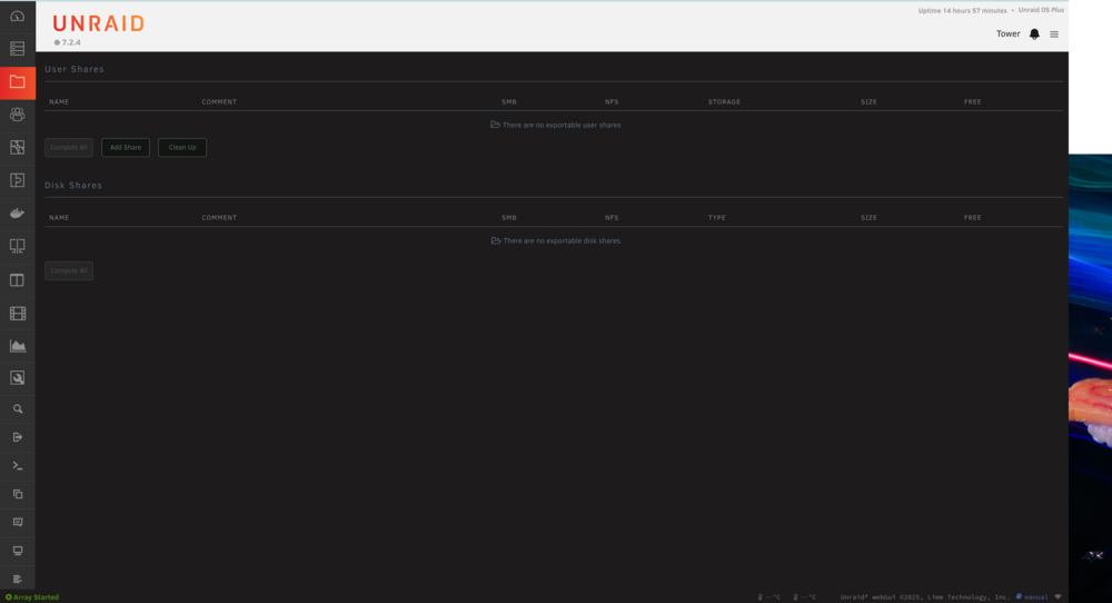

After a reboot I have lost all access to my User Shares. I've tried of number of things to get this working again , all to failure.
I also cannot start any Docker Conatiners, I get a "Invalid Parameters" error, I assume because of the missing shares.
VM's work just fine though interesting enough.
Any help would be appreciated, this server is my lifeline for many things and I'm hoping the solution isn't monumental.
Thanks,

Disk 3 failed and is being emulated
My bad, I can still check and repair. There was def corruption that needed fixing. Let me see if it worked.
Im getting "Bad Parameter" when starting any docker containers, but my shares are back and the corruption was repaired. THANK YOU. Making progress.
