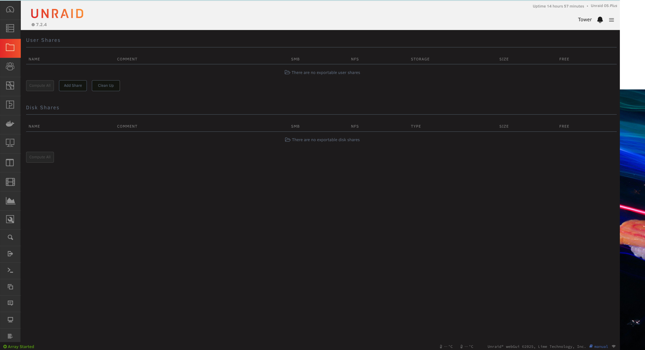

  3. How does one specifiy a folder over an image? And the drive is still connected but seems to have completely died, not sure. I don't know why that would cause my docker containers to stop functioning.
  4. After reboot tower-diagnostics-#4.zip
  5. I restarted docker but missed the reboot step, doing so now and will repost diagnostic #4 after reboot
  6. Fixed the errors in common problems tower-diagnostics-#3.zip
  7. Here we go tower-diagnostics-#2.zip
  8. Im getting "Bad Parameter" when starting any docker containers, but my shares are back and the corruption was repaired. THANK YOU. Making progress.
  9. My bad, I can still check and repair. There was def corruption that needed fixing. Let me see if it worked.
  10. Disk 3 failed and is being emulated
