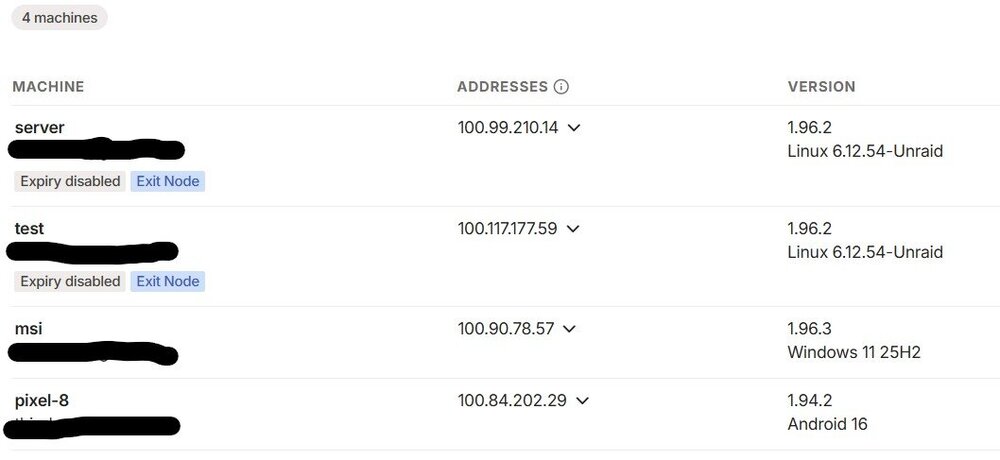

March 23Mar 23 Good day,I have my main Unraid server which I setup Tailscale plugin recently. It works great using the exit node feature with little to no fuss.Last week I received a low power SuperMicro 1U server so I decided to launch another Unraid Server that I would keep up 24/7. Following all the same steps as the first server, I've had some difficulty getting the Exit Node to pass traffic. I am receiving DNS errors when using web browsers such as chrome on my Windows 11 PC & Android Phone. On the Client side, if i switch to my first server there is no issues. I have reviewed the settings between both machines but cannot see any difference. I have pulled the Plugin Diagnostics which also contains the Unraid 7.2.4 Diagnostics within for review along with a screenshot of my Tail Scale Admin Console. Tailscale is UP on the Supermicro device (named TEST) and I can ping IP addresses from clients connected to this Exit Node so it seems there is some DNS error I'm not seeing or understanding. Any help would be appreciated. Thank you, TEST-tailscale-diag-20260322-181911.zip
