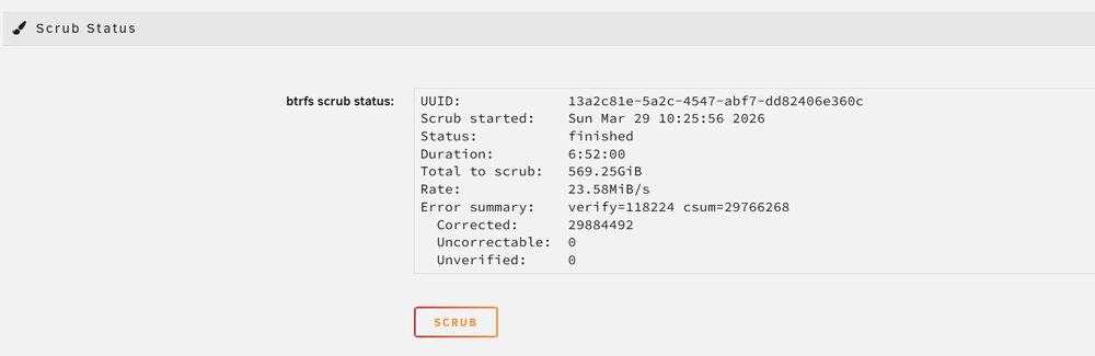

Thanks for the links and direction Jorge, that did the trick! Scrubbed, then went through and deleted the Docker image and recreated it, completely back up and running now thanks for your help!
