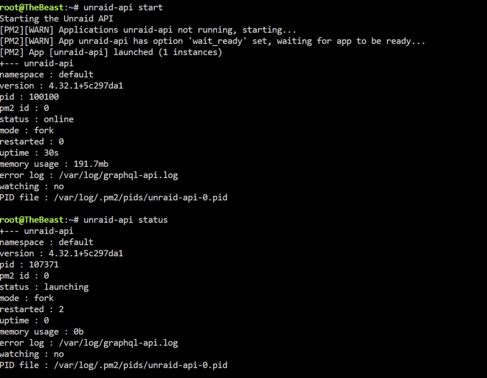

root@UR1:~# unraid-api status
+--- unraid-api
namespace : default
version : 4.31.1+726ae51e
pid : 2741199
pm2 id : 0
status : launching
mode : fork
restarted : 7498
uptime : 0
memory usage : 0b
error log : /var/log/graphql-api.log
watching : no
PID file : /var/log/.pm2/pids/unraid-api-0.pid

It's stuck in a restart loop, to confirm if it's a config problem, you can boot with a different flash drive using a stock Unraid install, no key needed, just check if the API starts.

now it no loimage.pngnger restarts
