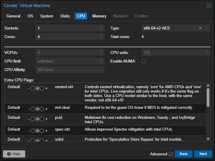

First lets create a VM:
It Is Important to Note THE internal Boot needs TPM and Potentaly Secure boot key...
Screenshot 2026-04-01 131706.pngScreenshot 2026-04-01 131721.pngScreenshot 2026-04-01 131749.png

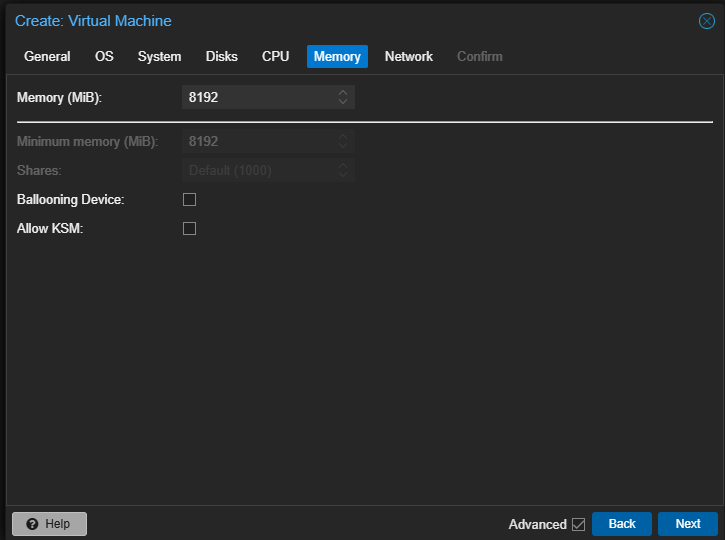

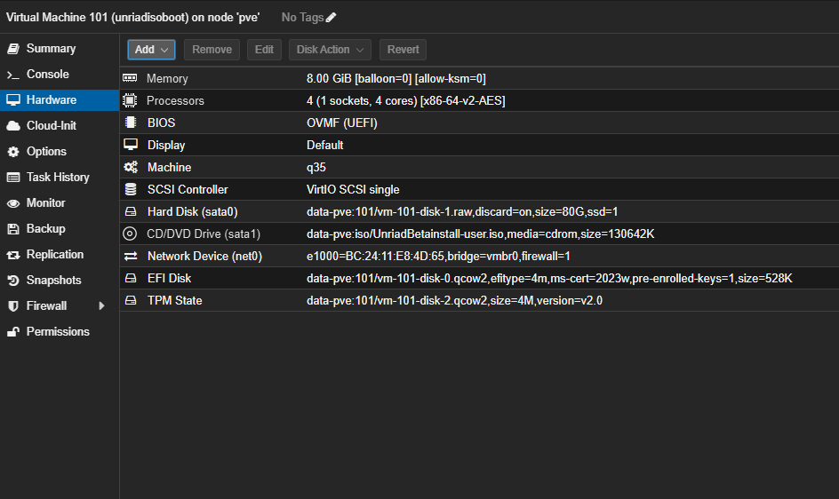

Pleas Note YOU MUST TURN OFF BALLONNING AND ALLOW KSM! Unraid exists in RAM even after boot.
This is a bare min PVE configuration on lattest PVE version 9.1.6 as of writing.

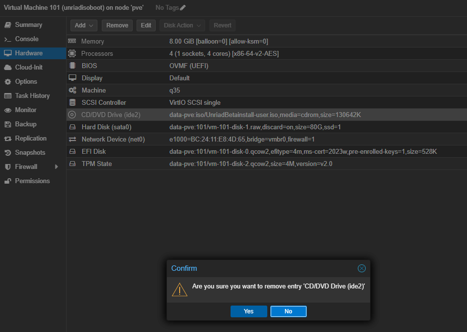

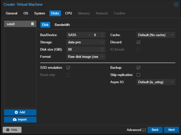

One of the first things I do is keep the connections SATA at creation teh HD is sata 0 So let's remove the disk drive and readd it as sata 1.

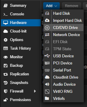

Now that the cd rom is removed, we need to recreate it.

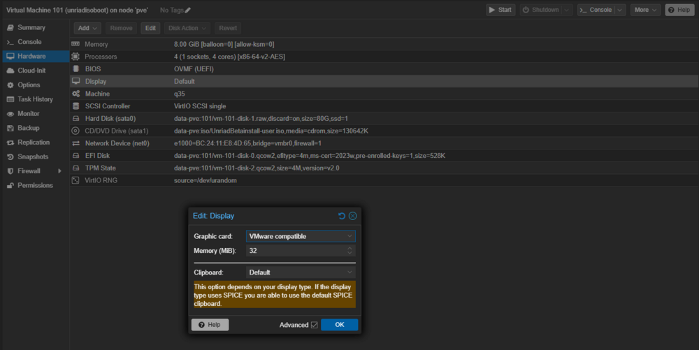

We alos want to add a VirtIO RNG
and edit the display options to asist GUIi based installs via ISO

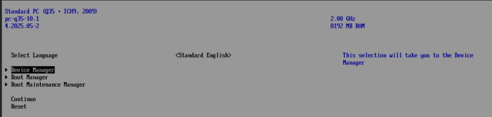

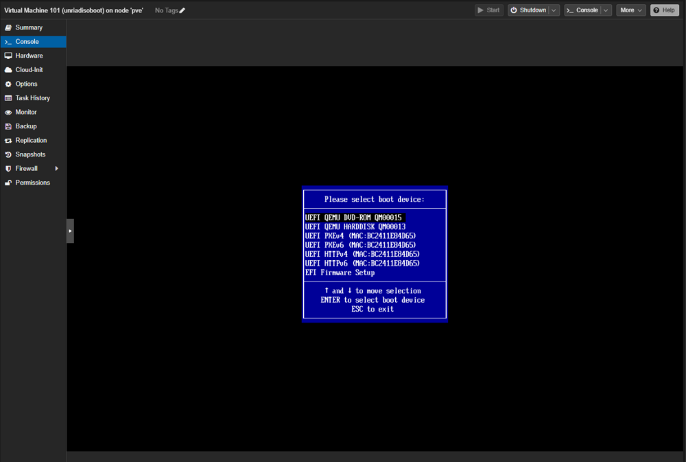

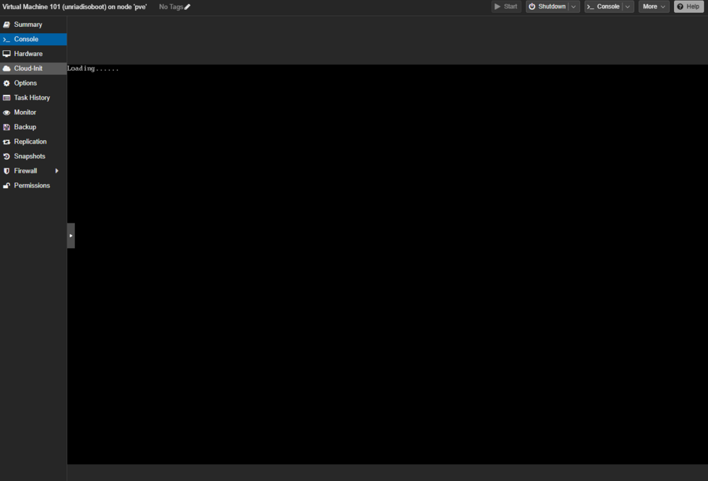

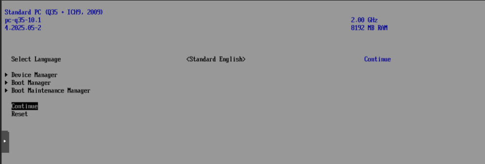

Now it time to start the console and enter BIOS by clicking in the console and hitting "esc" multiple times to get to the boot menu:

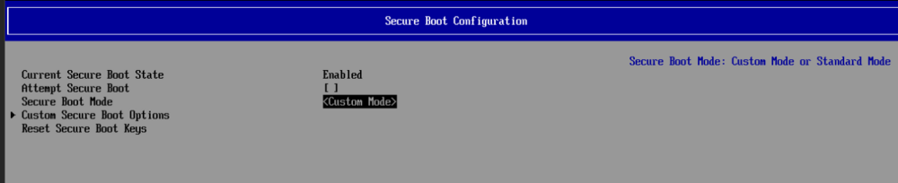

The goal is to disable secureboot and enable custom Secure Boot keys.

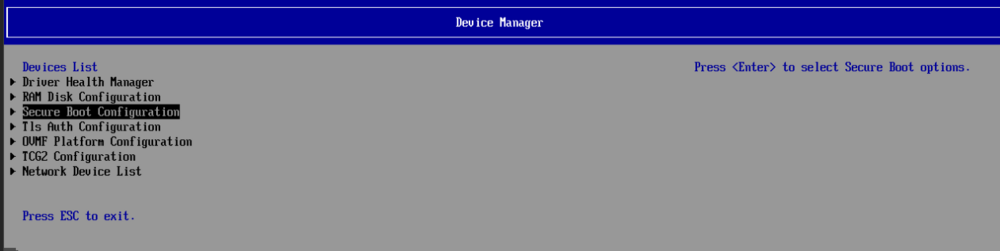

This should get you into PVE boot menu

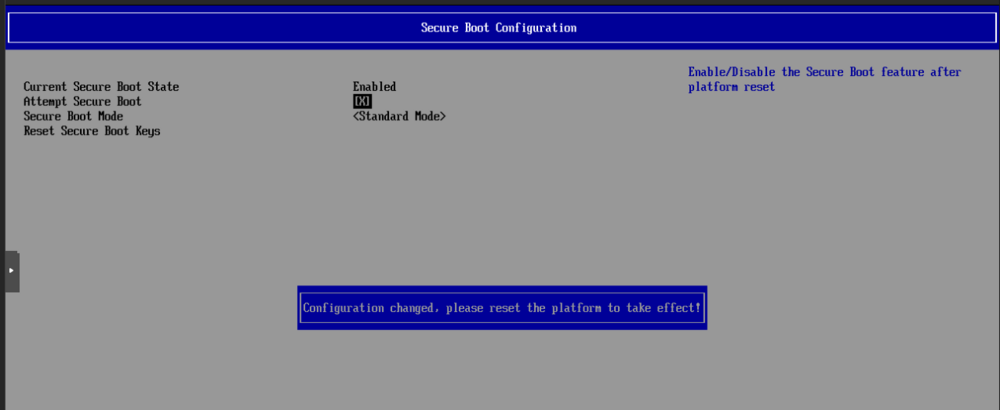

Go to Device Manger > Secure Boot Configuration
arrow keys to the X and hit space bar
and change standard to Custom Mode

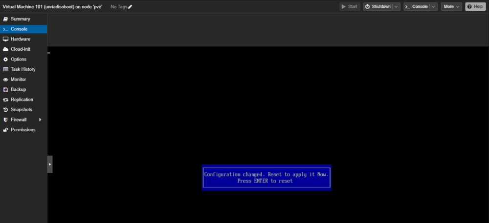

DON"T FORGET TO HIT f10 and y to SAVE!
Then hit "esc" multiple times and hit continue to boot You have successfully set up Unraid for Generic Default Linux Secure Boot and Stable VM Boot

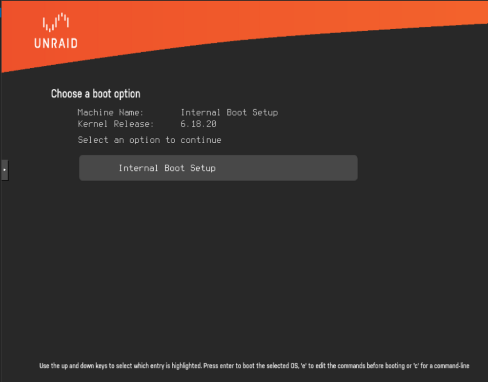

Screenshot 2026-04-01 132205.pngScreenshot 2026-04-01 132219.pngScreenshot 2026-04-01 132511.png

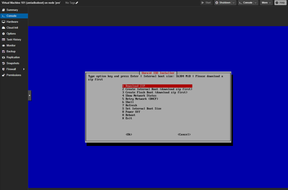

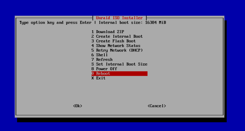

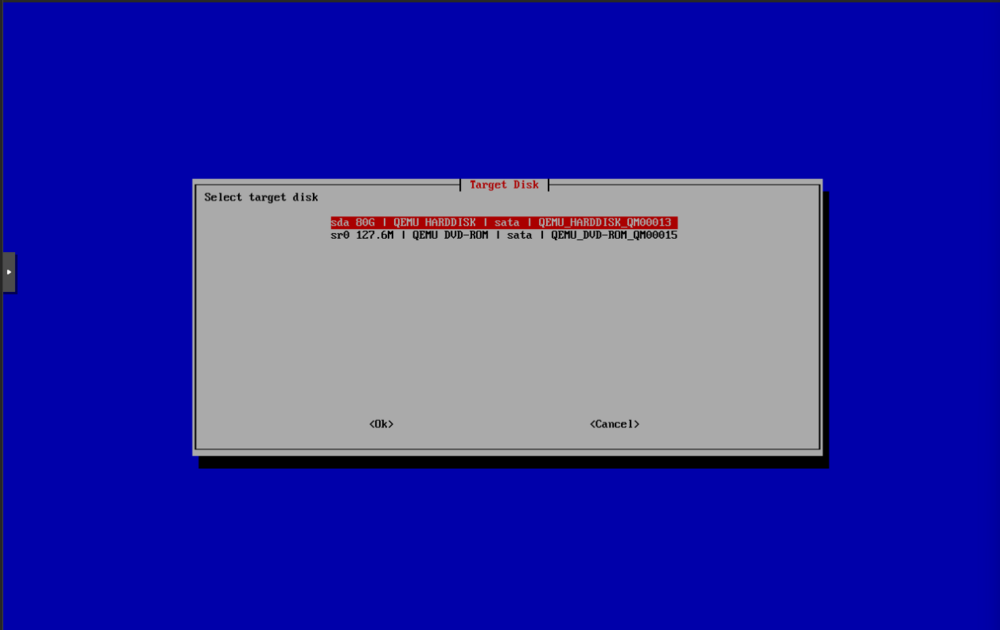

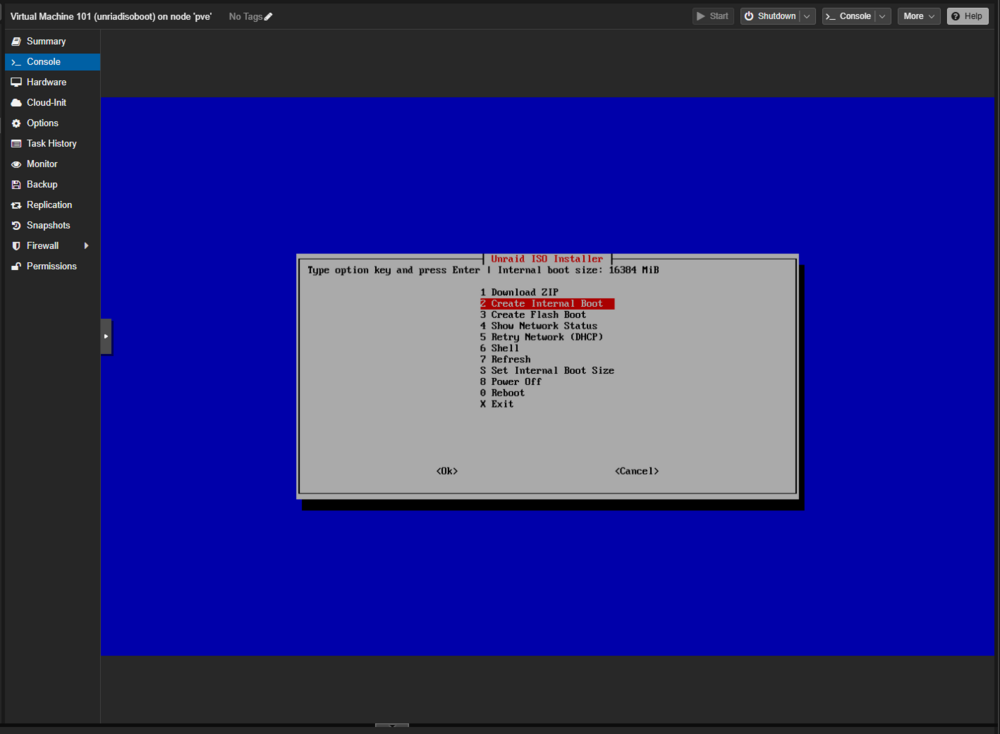

The ISO lads and the initial Boot Process begin.

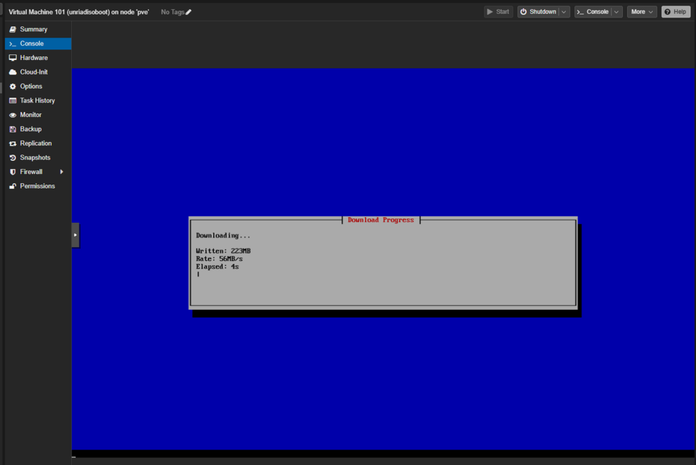

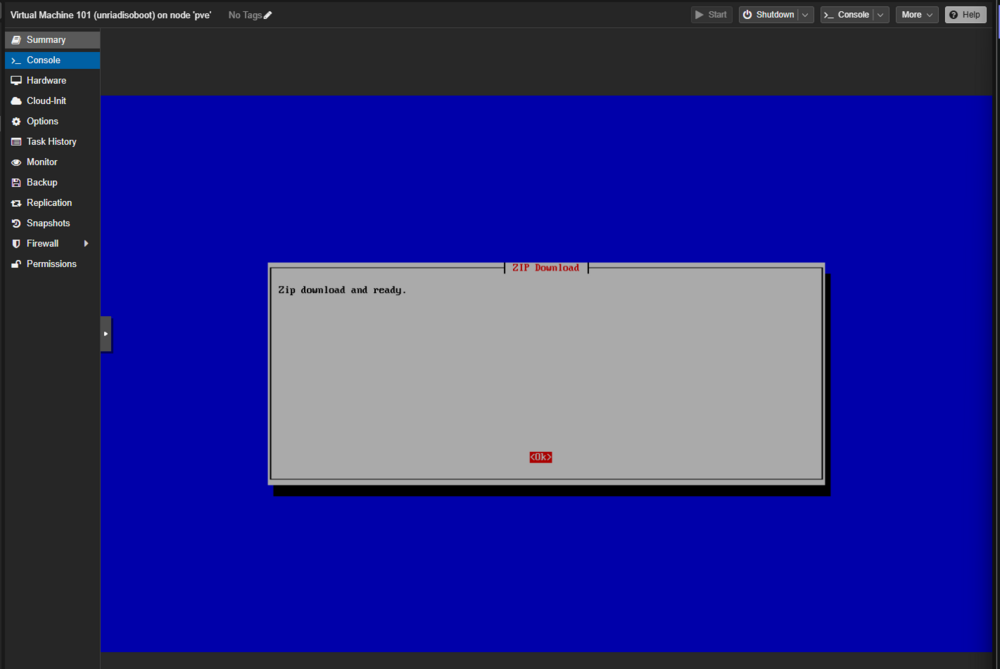

We must first download the Uriad Zip file:
Screenshot 2026-04-01 132518.pngScreenshot 2026-04-01 132543.pngScreenshot 2026-04-01 132607.pngScreenshot 2026-04-01 132625.png

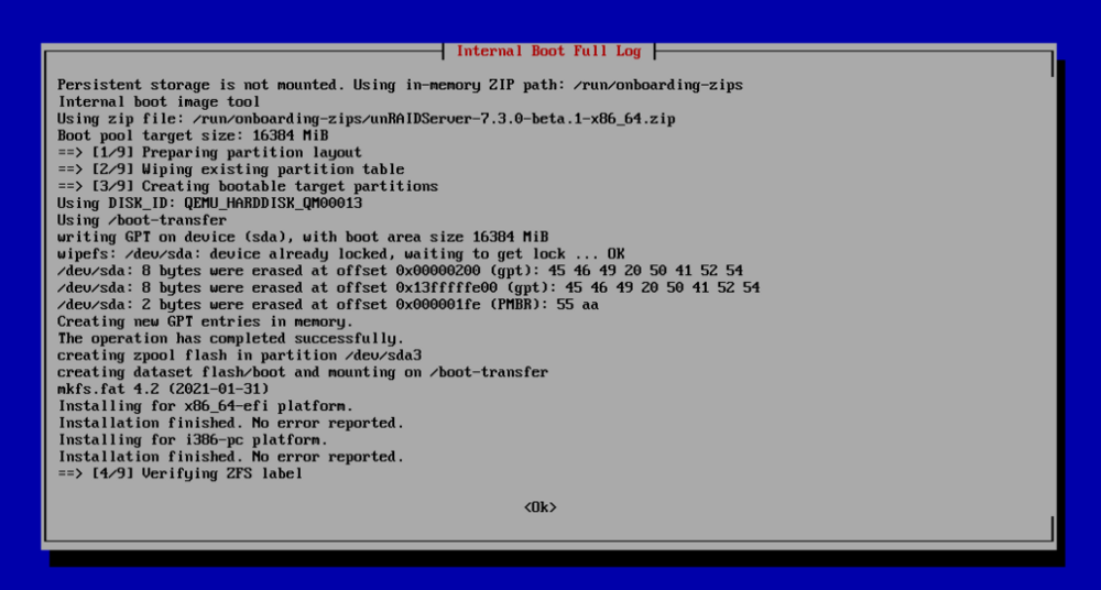

We then select option 2 with the current ISO pointing at the beta zip file.
Screenshot 2026-04-01 144955.pngScreenshot 2026-04-01 145005.pngScreenshot 2026-04-01 145019.pngScreenshot 2026-04-01 145106.pngScreenshot 2026-04-01 145149.pngScreenshot 2026-04-01 145200.pngScreenshot 2026-04-01 145209.png
By Default the Option is NO
But lets see the Log and what it did:

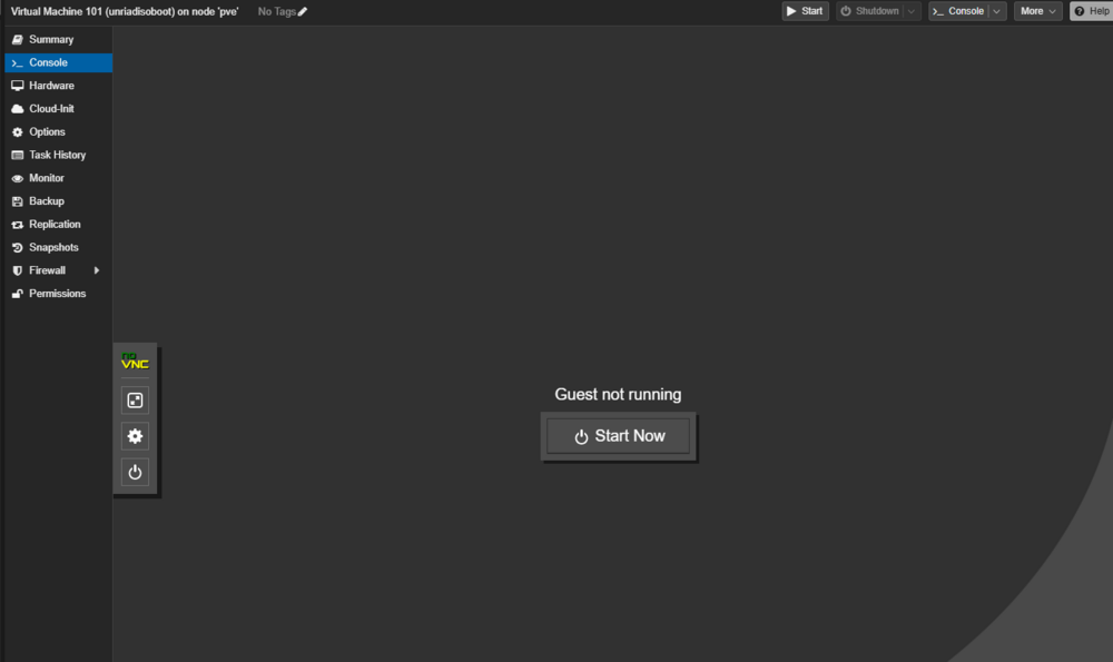

Thats it We now need to power off and tell boot options to boot to the HD first. It is better to Power off

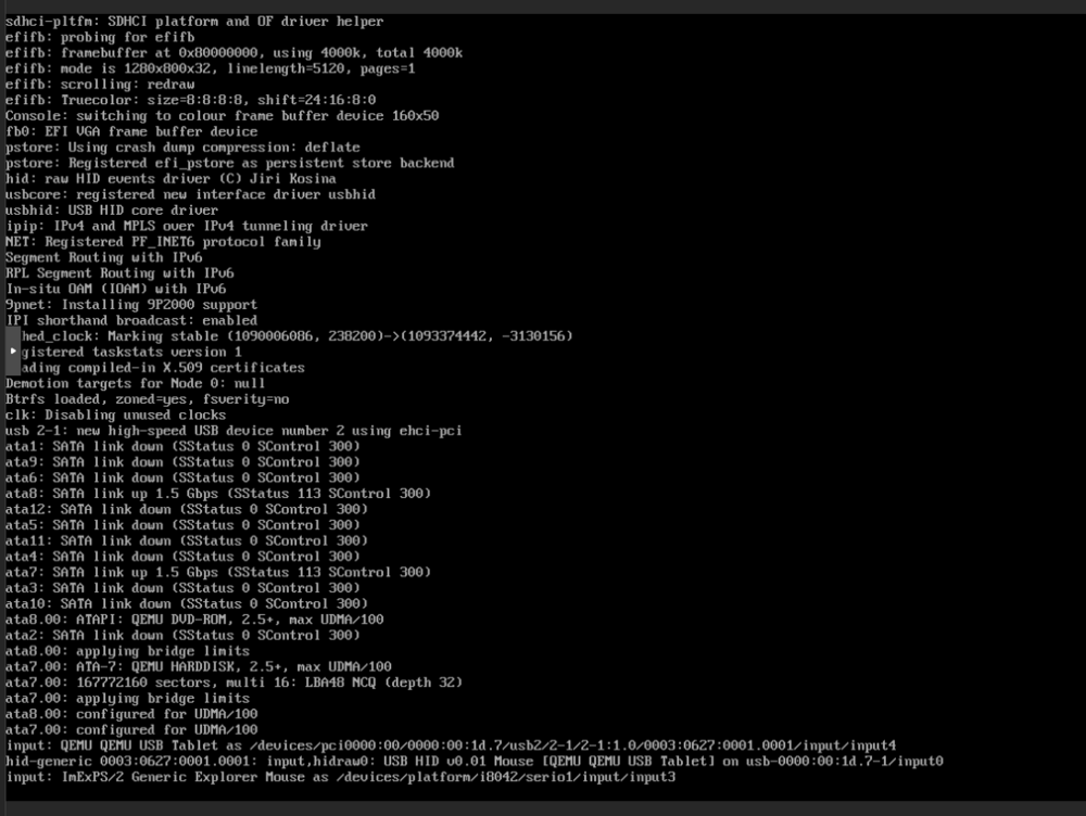

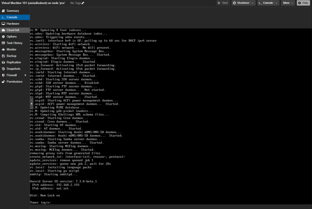

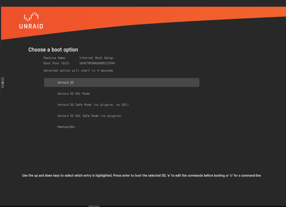

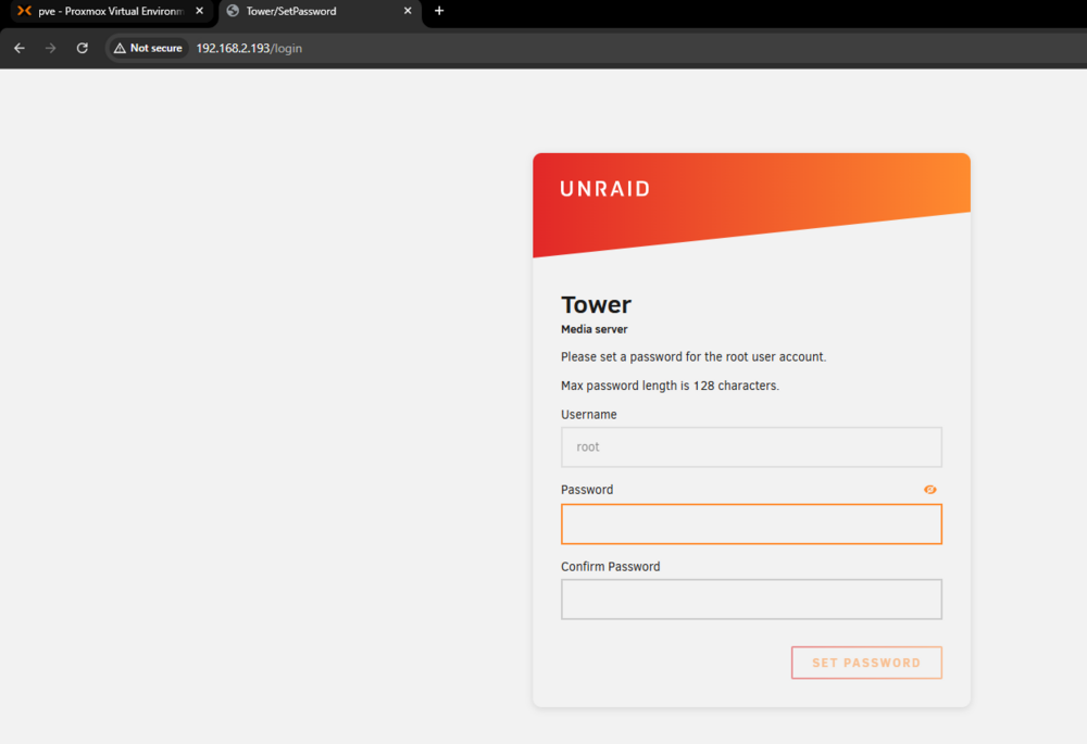

And now enjoy unriad booting form a HDD:
Screenshot 2026-04-01 145459.pngScreenshot 2026-04-01 145506.pngScreenshot 2026-04-01 145534.png

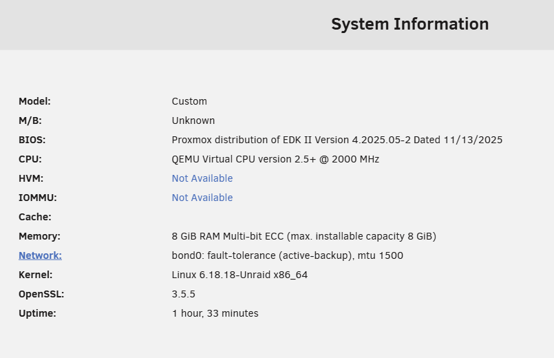

Let's take a look around

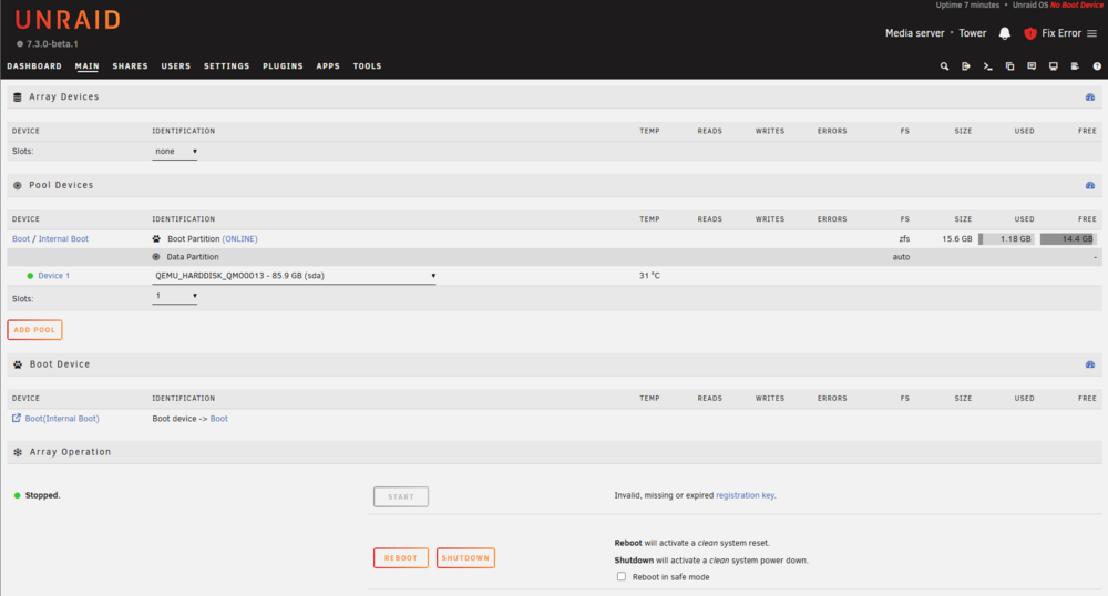

Yes, this installation makes the boot partition a ZFS Partition:

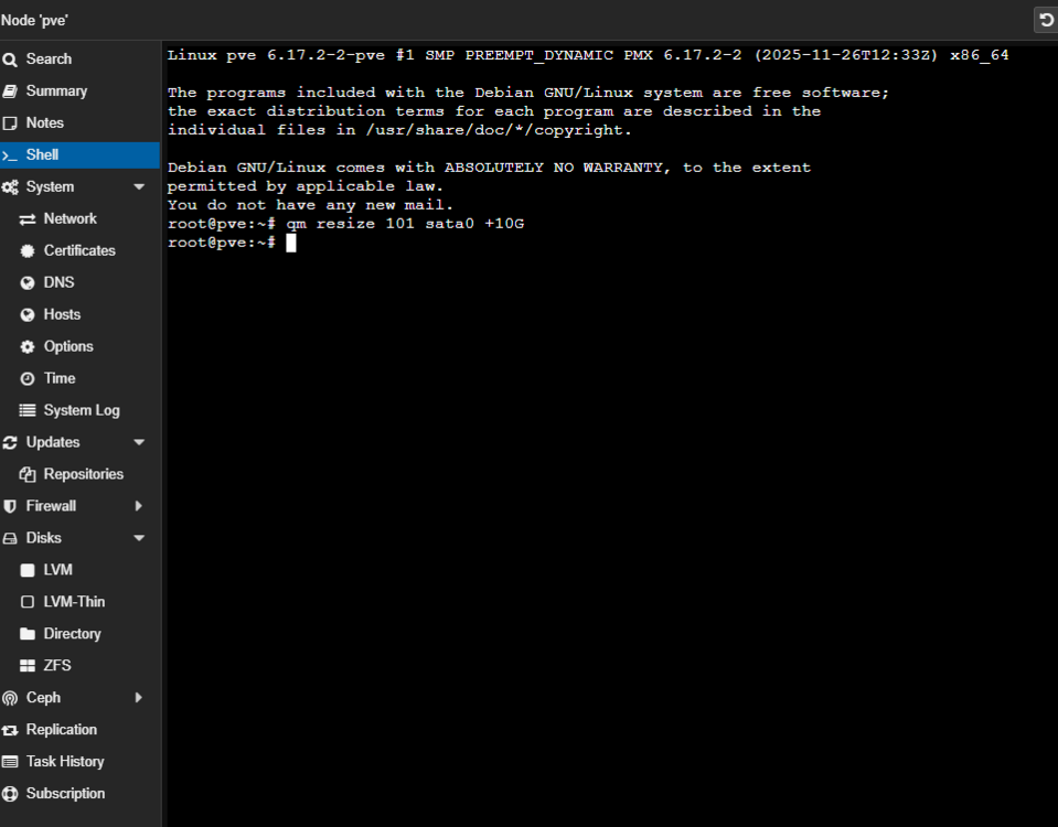

I've noticed a small PVE QEMU virtualized unraid issues where its format doesn't allocate or read the VM disk even when set to raw. I ofter after in have to add 10 GB-ish more to the Virtual disk to help with disk size and format allocation.
In my case, this is VM 101 and the disk is sata0 the PVE command to assign more data to the VM disk as I only gave 80 GB but as you can see per the web UI its reading 85...
qm resize 101 sata0 +10G
Note adding size doesn't change the partition. Usually, other disk commands are needed when you add storage to expand and use the added space...
Power off and power on and lets take another look...

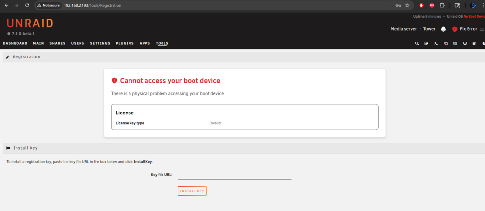

(as this is/ was more for testing... ) I'm not ready to move a paid key over and boot mode requires a paid key can't do a trial at boot on beta instance for test... Given Virtualized HD is being read as "Invalid".)
Unraid OS No Boot Device
tower-diagnostics-20260401-1646.zip
