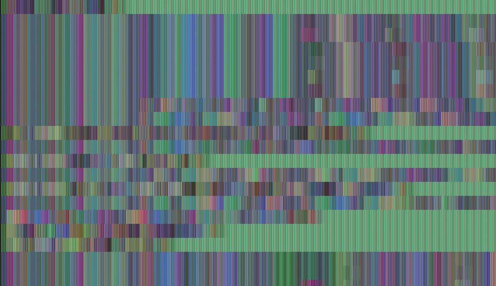

When I go to view logs the screen looks funky and I can't read the text, so I have to select all, and copy then paste to a notepad. It looks like this...

2026-04-12 16:56:07.658+0000: Domain id=8 is tainted: high-privileges
2026-04-12 16:56:07.658+0000: Domain id=8 is tainted: custom-argv
char device redirected to /dev/pts/0 (label charserial0)
2026-04-12T16:56:10.500035Z qemu-system-x86_64: VFIO_MAP_DMA failed: Invalid argument
2026-04-12T16:56:10.500075Z qemu-system-x86_64: vfio_container_dma_map(0x560570a206d0, 0x383000000000, 0x10000000, 0x154a70000000) = -2 (No such file or directory)
2026-04-12T16:56:10.500154Z qemu-system-x86_64: VFIO_MAP_DMA failed: Invalid argument
2026-04-12T16:56:10.500157Z qemu-system-x86_64: vfio_container_dma_map(0x560570a206d0, 0x383010000000, 0x2000000, 0x154a86000000) = -22 (Invalid argument)
2026-04-12T16:56:10.514203Z qemu-system-x86_64: VFIO_MAP_DMA failed: Invalid argument
2026-04-12T16:56:10.514214Z qemu-system-x86_64: vfio_container_dma_map(0x560570a206d0, 0x383000000000, 0x10000000, 0x154a70000000) = -22 (Invalid argument)
2026-04-12T16:56:10.514487Z qemu-system-x86_64: VFIO_MAP_DMA failed: Invalid argument
2026-04-12T16:56:10.514492Z qemu-system-x86_64: vfio_container_dma_map(0x560570a206d0, 0x383010000000, 0x2000000, 0x154a86000000) = -22 (Invalid argument)
2026-04-12T16:56:10.543535Z qemu-system-x86_64: VFIO_MAP_DMA failed: Invalid argument
2026-04-12T16:56:10.543547Z qemu-system-x86_64: vfio_container_dma_map(0x560570a206d0, 0x383000000000, 0x10000000, 0x154a70000000) = -22 (Invalid argument)
2026-04-12T16:56:10.543651Z qemu-system-x86_64: VFIO_MAP_DMA failed: Invalid argument
2026-04-12T16:56:10.543654Z qemu-system-x86_64: vfio_container_dma_map(0x560570a206d0, 0x383010000000, 0x2000000, 0x154a86000000) = -22 (Invalid argument)
