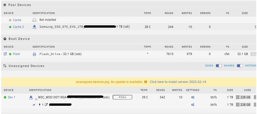

However I'm now seeing a new issue where (and probably because my config folder was out of date). I can create a new thread if you wish, please advise, but the long and short of it is that I had my cache drives in a RAID1 for redundancy. When I booted up after this fix, it showed only a "Cache 2" under "Pool Devices".
Under "Unassigned Devices" I see Dev 1 and confirmed it is the other cache drive. It had a button beside the drive identification that said [MOUNT] so I pressed that. It now shows the word "POOL" beside Dev 1 (under Unassigned Devices) but it doesn't show the drive as device "Cache" under "Pool Devices". I didn't want to start the array yet in case this would have negative impacts.

The array had been started in maintenance mode in order to rebuild the original failed drive in the data array. I have stopped the array and unfortunately clicking the POOL button doesn't appear to do anything. It appears to be greyed out.
Array is currently in stopped state.
The greyed out POOL button with the array stopped is likely why it's not responding.
Try starting the array first -- in maintenance mode is fine -- and then attempt the POOL button again on Dev 1 in Unassigned Devices.
The array being started doesn't mean data is at risk here.
The cache pool issue is separate from the array drives.
If the POOL button is still greyed out after starting the array, post a screenshot of what you're seeing and it would be worth opening a dedicated thread for this specific issue to get more focused help.

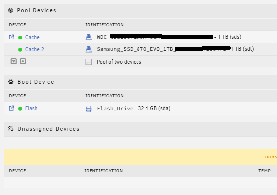

I was unable to select anything as the first cache drive from the drive selection dropdown box, and it remained in the unassigned devices with the [POOL] button greyed out. I started the array in maintenance mode, then stopped it. The Cache#1 dropdown box then became populated with the drive that was listed in the Unassigned Devices section. I chose the drive (WDC...) as Cache#1 and got the warning that the contents would be overwritten, and I proceeded. I started the array again, not in maintenance mode, and it's appearing as a cache pool now (Image attached). I don't think I'll need to post a follow-up help for the cache drive issue, but is there any way I can verify that Cache#1 actually equals Cache#2? I suppose because there's only one button to browse /mnt/cache that should be enough to verify?

Great result -- the pool looks exactly as it should.
To verify Cache and Cache 2 are consistent, run a BTRFS scrub on the cache pool.
It reads every block on both mirror members and compares checksums -- zero errors after completion confirms the mirror is healthy and both drives contain identical data.
