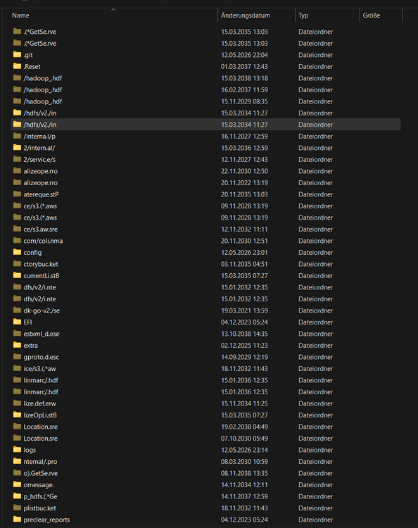

So I could restart a few times with the same result. Now I'm stuck in a BIOS screen loop. This is crazy. Probably broke the flash device.
This is my flash drive. No wonder I'm stuck in a BIOS loop. What the hell happened here?

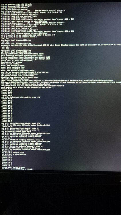

What I tried now is to use a different flash drive and created it with Unraid USB Creator directly for version 7.3.0. Now I see that: waiting up to 30 seconds for device with label UNRAID to come online.
I don't know what to do anymore.
Does it boot if the new flash drive has a stock 7.2 instead?

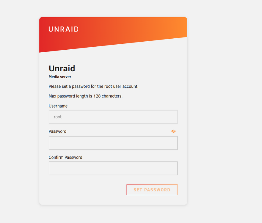

Ok, never mind, it is really like a fresh install. I'm scared to do anything right now. I had switched my WebUI port and now tried the default one and saw this:
But still, the question: what should I do now? I got flash drive backups with 7.2.6.

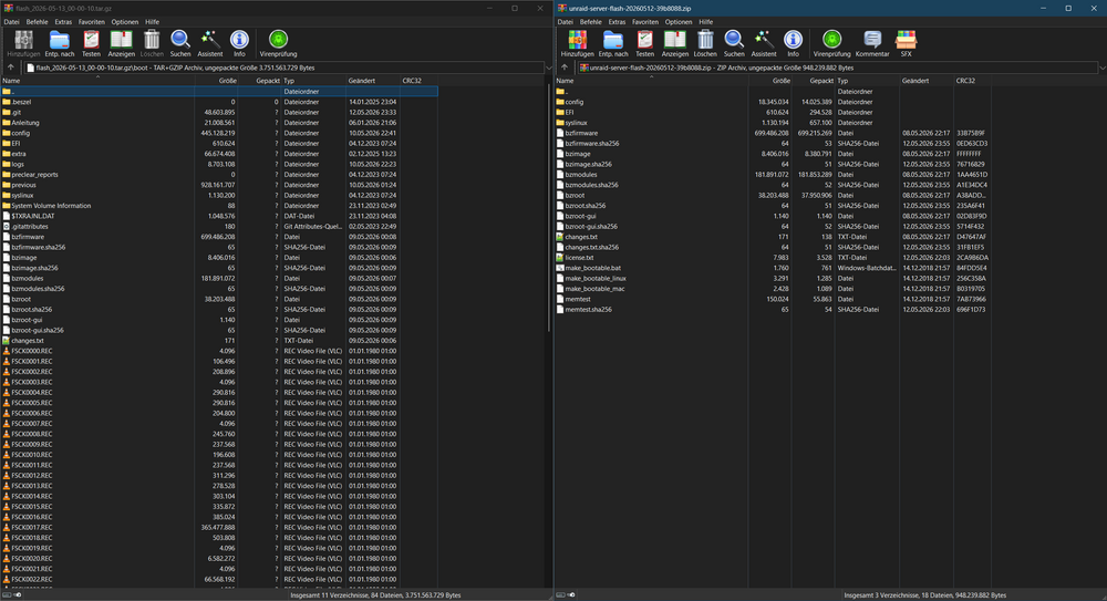

A comparison of my backups. Left side is my own backup of the whole flash drive and the right side is Unraid Connect backup. Why do they look so different, and can I restore the left side by just copying everything?
Edited by sasbro97
All those FSCK files suggest the flash drive or its filesystem were having issues, you can try restoring only the config folder from one of the backups, all settings are there, if it doesn't work, try the other one.
All the FSCK files on the left indicate files/folders that have been found to be corrupted when doing a file system check on the flash drive. This suggest to me there could also be corrupt config files on the backup.
