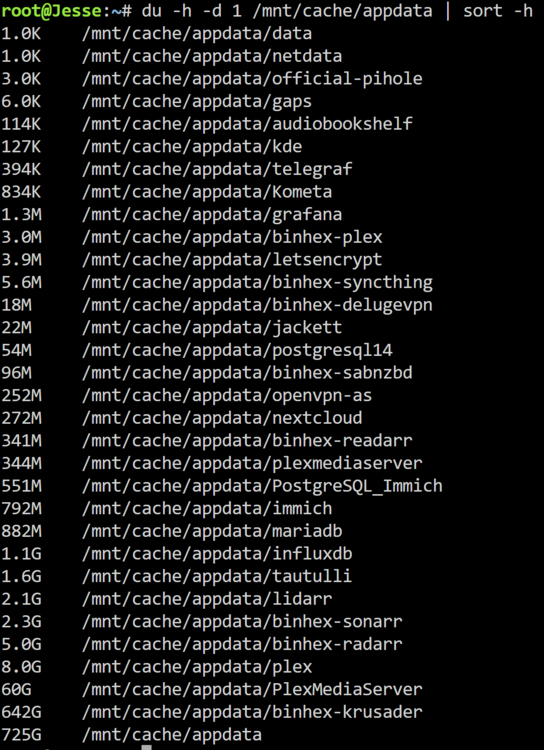

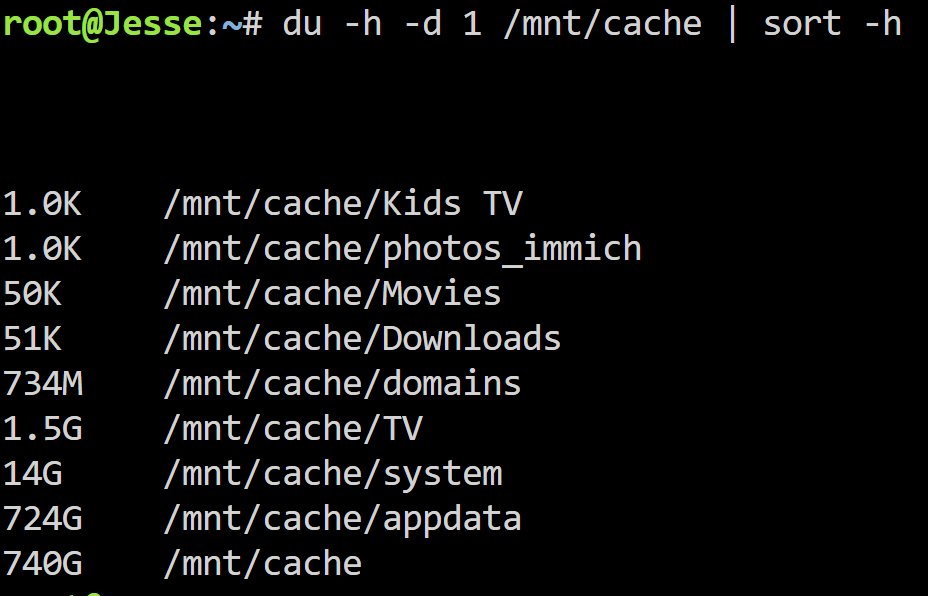

3. Cache drive still has about 1.1 TB used
Since the incident, the cache drive stays around 1.1 TB used, even after running mover.
I am not sure what data is still on the cache drive or whether it is supposed to remain there.
I would like help confirming:
  • What is currently using space on the cache drive?
  • Whether my shares are configured correctly for cache usage
  • Whether appdata, domains, system, downloads, or media files are stuck on cache
I have posted the output of:
du -h -d 1 /mnt/cache | sort -h

First thing you should do is set a Minimum Free Space setting on the 'cache' pool to stop it filling up in the first place.
In terms of looking to see what is using space on the 'cache' pool you can use Unraid's built-in File Manager to examine it. From the diagnostics it looks like 'appdata' is using around 724GB and 'system' around 14GB - not the total of 1.1TB you mentioned. You normally do want those 2 shares there for performance reasons.
