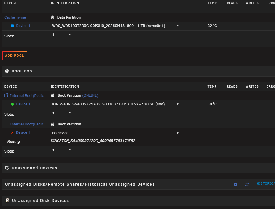

Used on SSD for Internal boot - Need help
I unassigned as old SDD for internal boot.

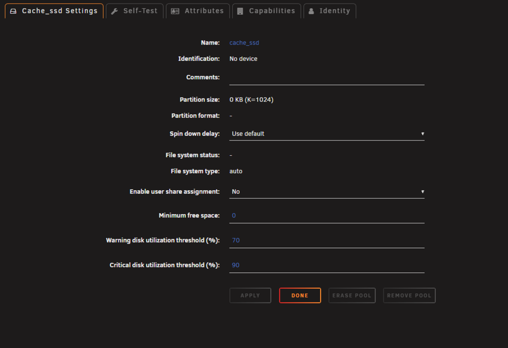

But I didnt remove it from the pool and now im stuck as I cant start the array as it is now a boot drive? Any way to remove it from the config?
I tried using the new config feature, but its still there.
I know, I'm an idiot :)
Type
mv /boot/config/pools/cache_ssd.cfg /boot/config/pools/cache_ssd.bak
Reboot and you shoudl be all set
Legend and thank you. Beer money incoming
