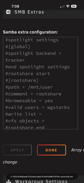

Recommend removing all the extra SMB parameters and retesting. If nothing else, they are spamming the log.
There don’t appear to be any SMB settings related to time machine but I have commented out all the settings.
First attempt after the change failed. Second one worked.
