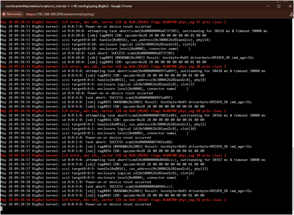

Upgrade went smoothly. Rebooted and immediately noticed that UNRAID CLI was reporting the following repeatedly when tyring to scan the hard drives:
May 28 09:21:55 BigBoi kernel: I/O error, dev sdh, sector 128 op 0x0:(READ) flags 0x80700 phys_seg 48 prio class 2
May 28 09:21:55 BigBoi kernel: sd 0:0:10:0: attempting task abort!scmd(0x00000000fcba39fa), outstanding for 30463 ms & timeout 30000 ms
May 28 09:21:55 BigBoi kernel: sd 0:0:10:0: [sdk] tag#5615 CDB: opcode=0x28 28 00 00 00 00 80 00 01 80 00
May 28 09:21:55 BigBoi kernel: scsi target0:0:10: handle(0x0018), sas_address(0x300062b202aed2ce), phy(14)
May 28 09:21:55 BigBoi kernel: scsi target0:0:10: enclosure logical id(0x500062b202aed2c0), slot(4)
May 28 09:21:55 BigBoi kernel: scsi target0:0:10: enclosure level(0x0000), connector name( )
May 28 09:21:55 BigBoi kernel: sd 0:0:7:0: Power-on or device reset occurred
This happened over and over -- eventually the server booted (30-40 mins) and then allowed me to login where it struggled for another 30 mins to start the array (It eventually did)
I was able to grab snippets and diags prior to rolling back to 7.3.0.
Roll back successful and everything is running perfect on 7.3.0.
Happy to provide more information.

If it works fine again after downgrading it, it could be a kernel regression, the other LSI controller is apparently working fine, problem is just the 9305-16e.
It may be worth looking for a firmware update; we can also see if any other users report similar issues.
@JorgeB Fair enough. I didn't dive into the diagnostic- could you tell if the problem was actually coming from the 3216 or the 2308? I can check firmwares but i was pretty sure these old cards did not have updates.

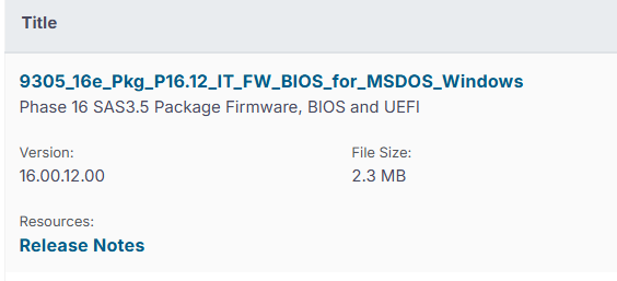

@JorgeB I could be wrong but for the 9305-16e it appears it is maxed out stable at:
IT_Nexus mode  - fw: 16.00.11.00, nvdata: 10.00.91.xx: Channel_9305-16e_IT_Nexus.bin
Abort Task Set - fw: 16.00.11.00, nvdata: 10.00.92.xx: Channel_9305-16e_ATS.bin
I don't believe there is anything newer but definitely could be wrong.
Skip
Edited by Skipdog
@jynxsee I wasn't following the answer "Same firmware" -- same firmware as what? Are you running 16.00.11.00 or 16.00.12.00 ?
@JorgeB I'm very hesitant to even try the firmware upgrade as it is the only card I have to drive the external enclosure and these cards have doubled in price now.. Definitely don't want to render my system unusable. I would love to find out if anyone else having this issue is already on 16.00.12...

OK some new data-
Upgraded to 16.00.12.00 and rebooted into the same 7.3.0 version to make sure everything worked good (it did)
Upgraded to 7.3.1 and rebooted and confirmed the timeout/resets are still happening (they are)
