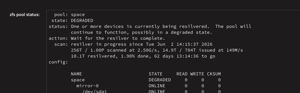

Hey @JorgeB thanks for the reply.
Unraid 7.3.1
Well, facepalm moment for me, as I read and typed too quickly. I thought your command would be to check if they were simultaneous, not to re-start the process.
I was monitoring the read/writes and there were matching reads<>writes on the various pairs.
Now, it just restarted the whole thing. :☹️ Back to 40 days ETA. Now I'm curious if the time will reduce quicker since the drives already have data, or will it start fresh again?

The only confidence I had, was watching the Main tab read/writes, the drives that were replaced had exact matching reads to write (16tb to 18TB) combinations. Other than that, I have no concrete evidence that it was in parallel. My incorrect assumption was the command above would check that, but as I said, I read too fast and incorrectly assumed that. haha my fault for sure.

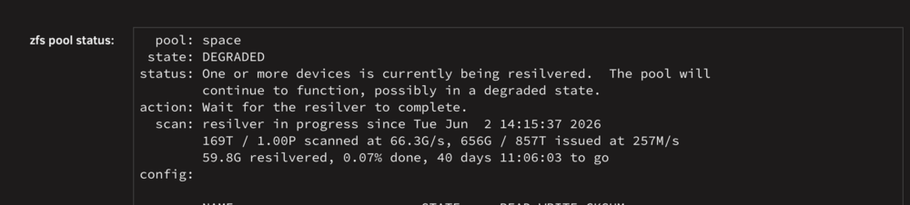

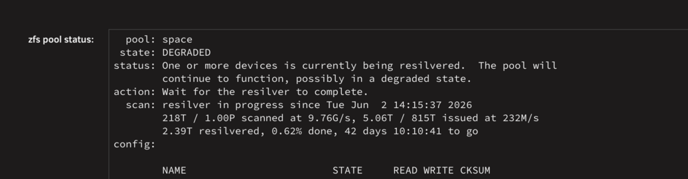

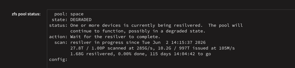

For now, I saw the stats on the pool page, reset. Here are two screen shots one from yesterday, one from just after I ran your command. As well as your requests:
June 01
June 02 (after command)
June 02 (now, looks like the process has scanned at a much higher rate than earlier)
Attached a 'print to pdf' of the Main tab, since it would take numerous screens (Let me know if you prefer screenshots, i can do that too)
server_Main.pdfserver-diagnostics-20260602-1456.zip

status update
I'll need to investigate why you ae siieng a different behaviour than in my testing.

Update for now + plus main-tab pdf attached again.
server_Main-2.pdf
Only this vdev is showing normal writes, are they still showing in parallel sometimes?
I just checked again. And you’re right only that one pair is active currently, I’ll check it a couple times in the next hour to see if there is any further activity.

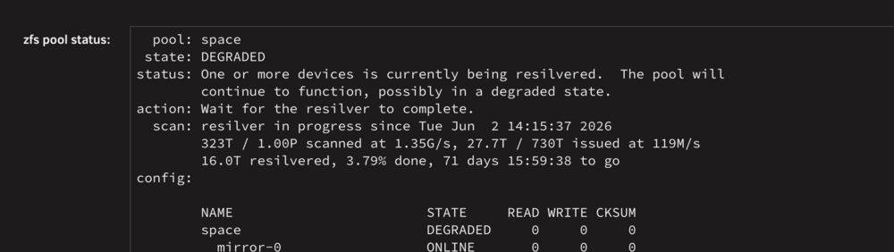

@JorgeB Sorry I am out of town this weekend, so my responses are a little slower than usual. I am watching the process right now, and there seems to be a lot of reads, and occasional writes. But nothing perfectly symmetrical like the last example we just looked at. Here is the current status, and then 3x PDFs of the drives read/writes. (me trying to capture the read/writes in varying states over the last few minutes.
server_Main-5.pdf server_Main-4.pdf server_Main-3.pdf
That behavior seems strange to me, but it's such a large pool, so it may be different than I expect.
I've also done some tests, and sometimes when resilvering multiple devices, it doesn't do any parallel resilver; other times, it does parallel for all; sometimes only a couple of the devices are resilvered in parallel, but not all, still I don't know why the difference; investigating.
In any case, my recommendation for now would be to just let it finish.

@JorgeB Small update today when checking.. Attached you can see the parallel symmetrical read/writes.
edit: Adding second PDF, showing excellent speeds on the read/writes. This is similar to past experiences, once long ago when you and I discussed how ZFS will "scrub" the whole pool during a resilver. And once just before the recent command run... Meaning I think the resilver will start progressing faster as more of the pool as been read.

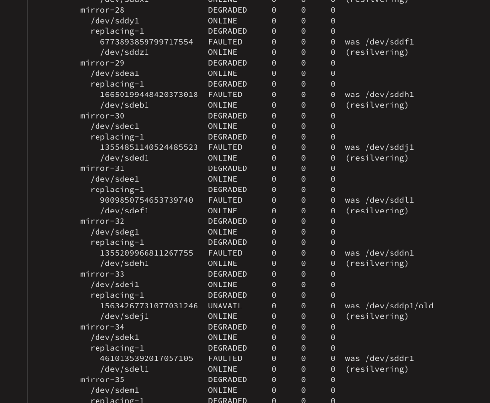

I did find why it can show the "cant_open" errors for some devices. In the example above, you can see it's showing device 14 as "offline/cant_open", it can happen if the disk being resilvered has the same /dev/sdX as a disk that was previously being used on the pool, and also being resilvered (likely only if the previous disk is listed before the new one in the zpool status output)
This is just a display issue, and will correct itself once the resilver finishes, but now that I know what causes it, I'll create a bug report.

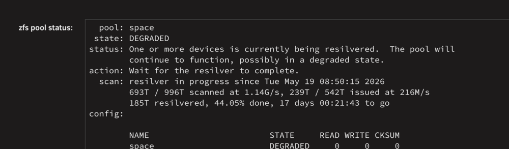

Question 1: Can I stop the server, and when it comes back online and the array starts... the resilvering resumes correct? NOT a restart?
Question 2: When reading the status of the pool, it appears to me that only 431T of the full 1PB pool has been 'read/scanned/scrubbed' ... is that correct, or is the 'issued' number?
I ask, as I am looking at the MAIN tab (updated attachment), the resilver/copy numbers we are talking about above, and ONLY that data transfer is occurring. Meaning Drive<>Drive copy to replace the mirrrors. I don't see any other activity (of decent speed) for any other drive. Note, I have basically all my services turned off, so there should be no data movement other than the resilver. BUT If the full pool 1PB of data hasnt been scanned yet, at what point does it start processing the rest of the data?
This is the scanned metadata, and the value should keep increasing as the resilver progresses, and it typically reaches the full capacity (1 TB in this case) before the pool is fully resilvered.

@JorgeB Maybe at this point I should create a new topic to discuss this further, but I am still a bit confused on the tasks to rebuild mirrored sets.
My 'resilver' has now slowed down tremendously.
You can see the speeds of scanned and issued are much slower. I am getting much more random reads compared to writes.

Very odd and sporadic read/writes now, see attached
server_Main-14.pdf
Let's first see if the io looks normal or if there's one or more disks slowing the resilver:
zpool iostat -vyl 10 1 > /boot/1.txt
Repeat that command a couple more times (wait a minute or so between runs), changing the destination file name only, e.g., 2.txt and 3.txt, then attach all 3 files here (they will be saved to the flash drive)
Just getting to this. Current state and attached PDF; as well as a few outputs from the above command.
Only 1 or 2 or the mirror pairs are moving data... The expected finish time is now climbing.
See page 2 of this thread to see another result
3.txt 2.txt 1.txt
