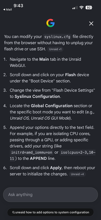

Not sure I understand how to do this. Tried googling and got this-
Not sure this is correct though since I don’t see a Syslinux Configuration tab anywhere.

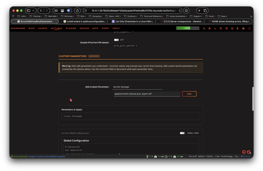

Settings - Boot Parameters, then add that option to the boot option you are using.
Maybe I found it? Is this correct???

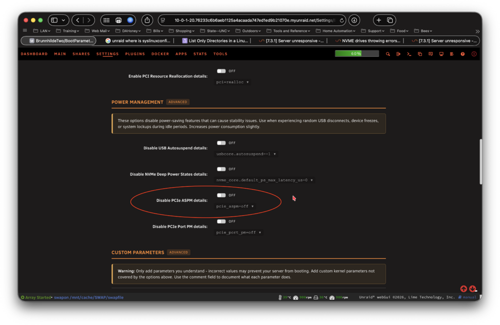

Like this???
Or maybe this?

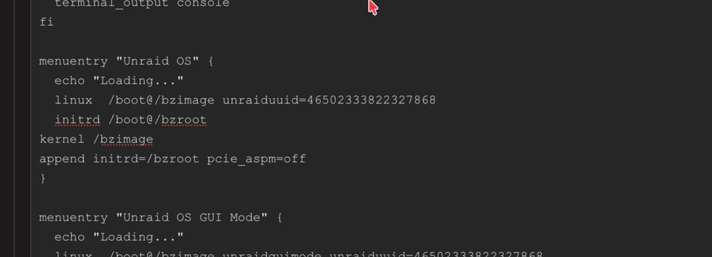

I used the switch and here are the current settings for my boot mode-
menuentry "Unraid OS" {
echo "Loading..."
linux /boot@/bzimage pcie_aspm=off
  linux /bzimage pcie_aspm=off
initrd /boot@/bzroot
Please confirm this is correct before I reboot.
You can use the toggle with 7.3.x, then reboot
