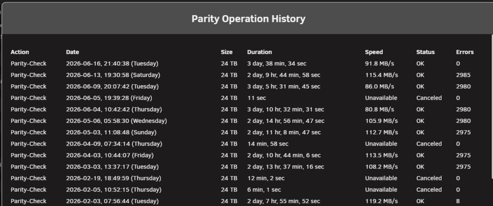

I run the parity checks on a monthly basis. The errors jumped right around the same time I replaced one 24tb parity drive with a new 24tb parity drive. I have run the Parity check - Check will start Parity-Check. (Schedule) With this, --> Write corrections to parity. Checked then immediately unchecked. The result does not reduce the error count from 2900 or so back to zero as expected.

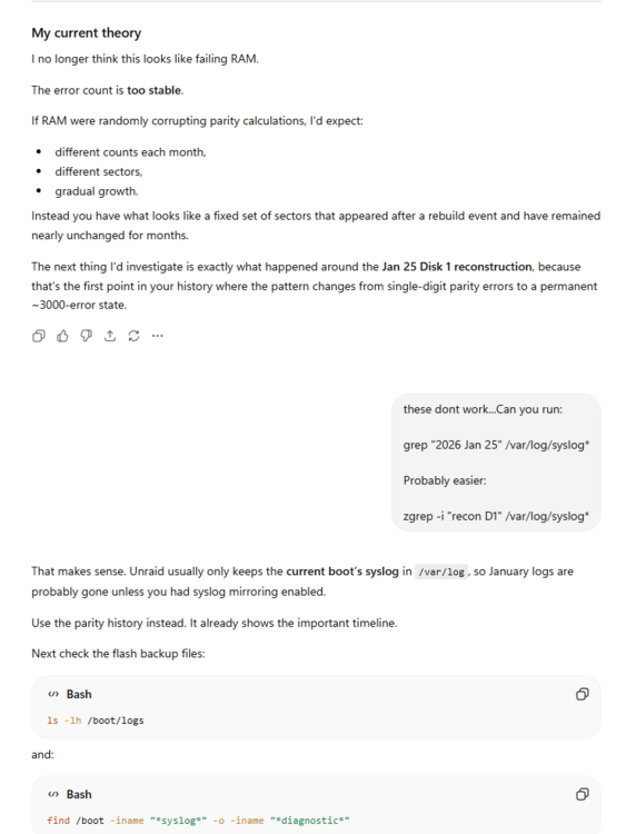

I went down a rabbit hole with ChatGPT and it seems to have ruled out bad RAM.
I am not sure if this will help or hurt the process of solving the problem, but here is my diagnostic journey so far...

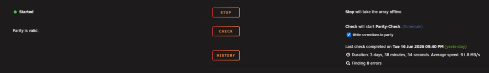

Rebooted, and I am running one with the blue Checkmark toggled ON "Write corrections to parity"

So now I guess I just need to run a few more Parity checks as JorgeB recommended. Seems like I am doing the same thing over as I have already done but I have not specifically done the order.
  1. Reboot
  2. Run checked
  3. Run unchecked
It is running right now with mdResyncCorr=1
And if the second check finds errors, post new diags.

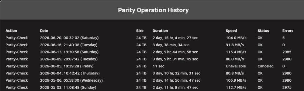

  • Darkoptix changed the title to I need some help fixing my Parity-Check Errors (Not Resolving after Write Corrections to Parity)
Well, just like that. I ask for help, and it fixes itself lol. The RESTART then instantly do both of the checks immediately after reboot is the only thing I changed.
Thanks JorgeB

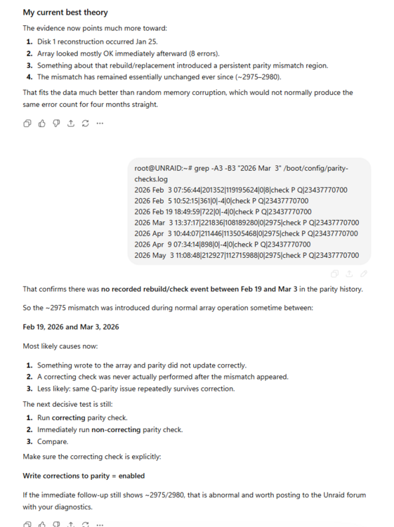

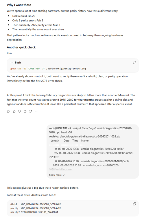

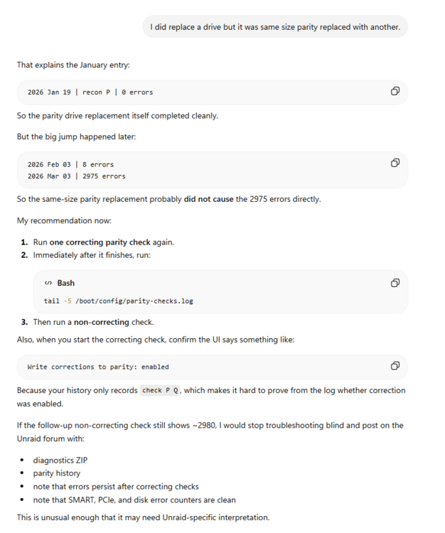

ChatGPT plan in case it helps anyone else. (Sounds reasonable to me).
There it is.
