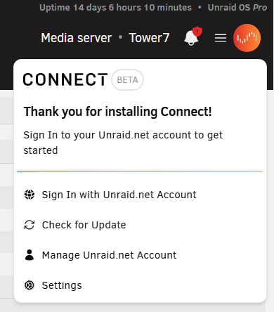

Yes I do. I click on "Sign In with Unraid.net account. That brings me to the account management page, and in there to my server management page.
When I click on "Register" it just redirects me to the login screen of my server, and it has not been registered.

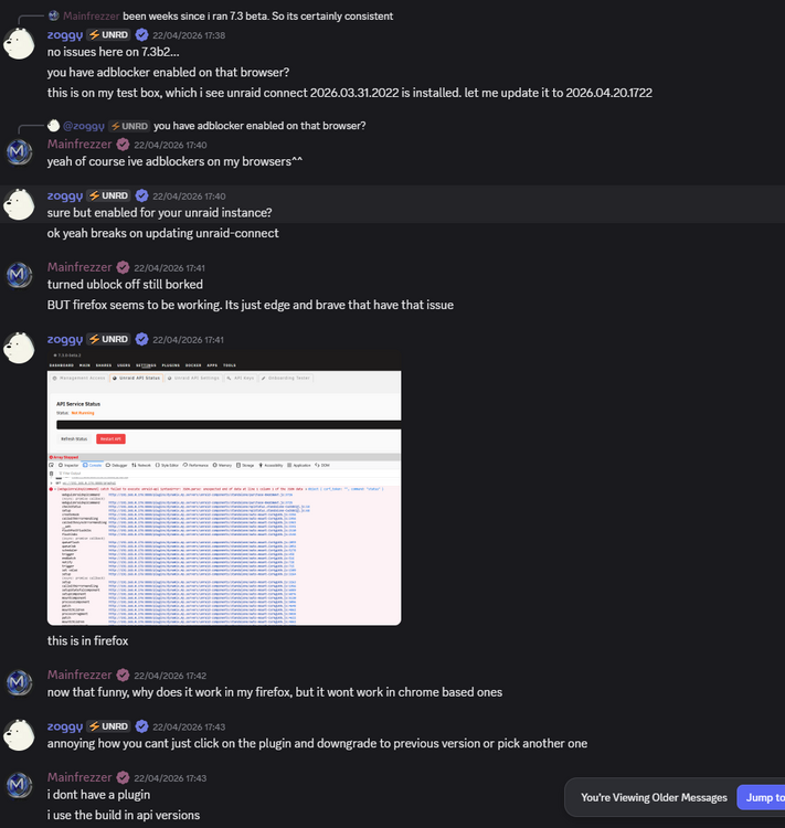

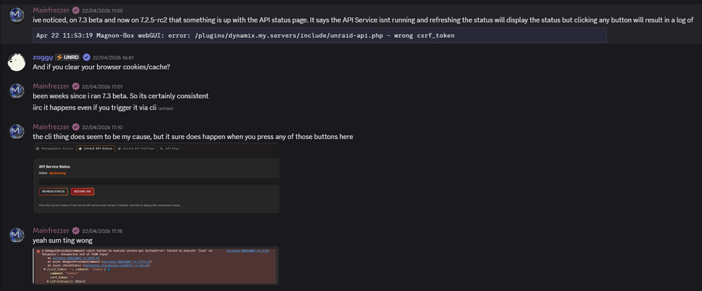

Theres some posts in the discord about it, been borked for a while and seems to be somewhat browser dependent but you do get different results for each person as it appears. Dont worry about it
