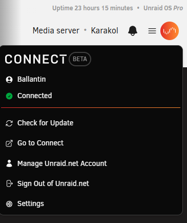

  4. Tried it and it did not fix the problem. Also in safe mode plugins are disabled, so Unraid Connect was disabled too.
  5. Here is my diagnostic data. karakol-diagnostics-20260612-1802.zip

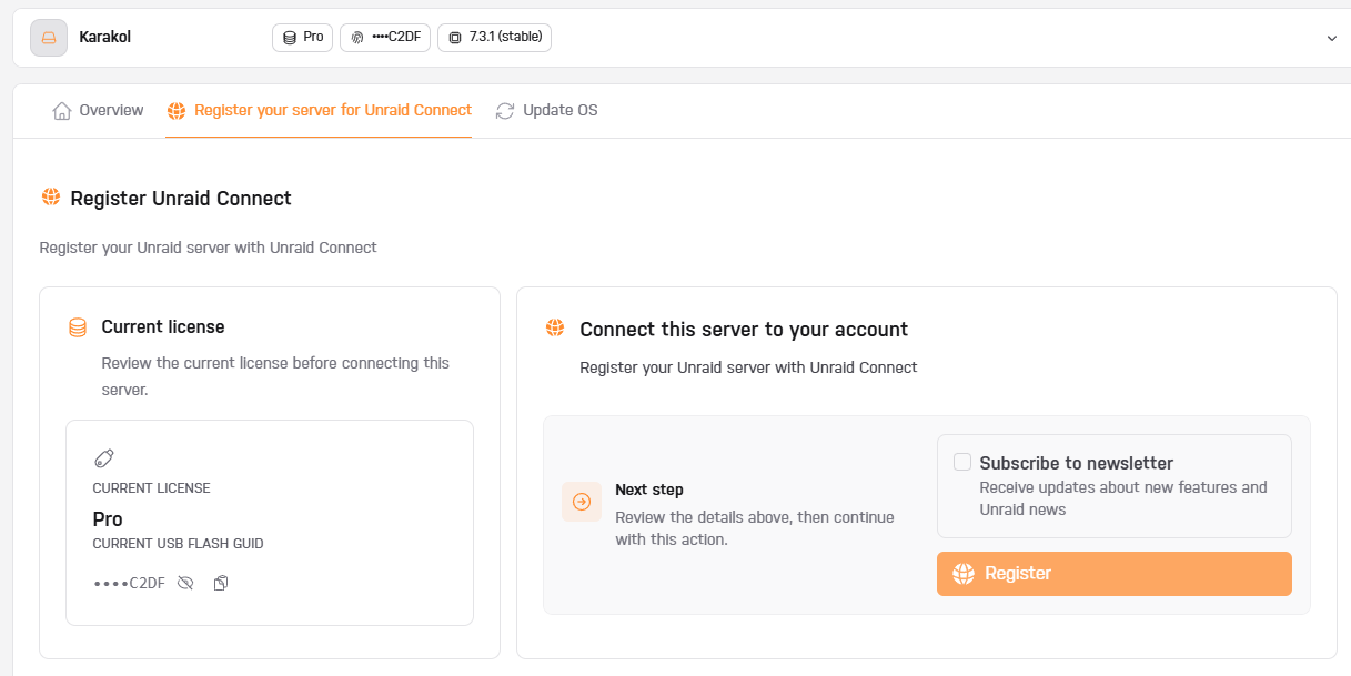

  6. Yes I do. I click on "Sign In with Unraid.net account. That brings me to the account management page, and in there to my server management page. When I click on "Register" it just redirects me to the login screen of my server, and it has not been registered.
  7. Thanks a lot, but unfortunately no. That's why I am asking for help, I have already searched the forum, reddit, and even asked several LLMs. None of the proposed solutions worked so far.
  8. When I try to register the server in Unraid Connect it just redirects me to the login screen of my server and it does not add it. I am in the latest version 7.3.1 I have the latest version of the plugin I have tried deleting the plugin, restarting the server and re-installing the plugin I have tried removing the server from my account and adding it again. I have tried restarting the API I don't know what else to try. Any suggestion will be appreciated.
