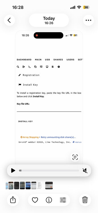

I also noticed when I tried to access my server via my tailscale IP address, the GUI was trying to put me through the new Onboarding Wizard. I thought it was weird that I could access it when this happened, but I have no idea why it would put me through the onboard wizard when I already did that. I attached a screenshot of my phone when I accessed it. While going through the wizard, the screenshot is what came up for a split second. I had to screen record to capture the image. It looks like there was something wrong with the license?
