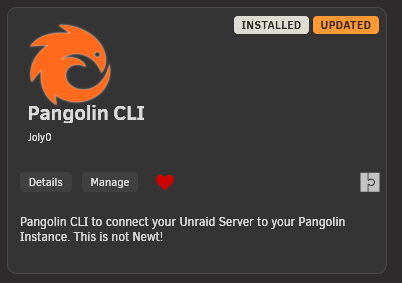

Pangolin CLI
An Unraid plugin that installs the Pangolin CLI and adds a settings page to connect your server to a Pangolin instance as a machine client. This lets you reach private resources directly on your Unraid host.
