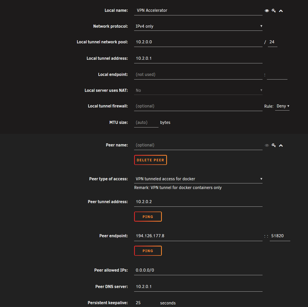

  6. yeah, I saw this. Adding the route mentioned in the post changed nothing and the --dns flag prevents the container from having any dns resolution. this is my vpn config:
  7. Do you mean Unraid Settings or pfSense? In Unraid the main DNS server is my firewall since I want the VPN connection to only apply to Docker Containers. If you mean the VPN DNS Settings then yes, I tried using the proton dns servers from the wireguard config, but I still get the above mentioned result from an apparent dns leak
  8. No one here running Unraid behind pfSense and has an idea where I could start to look for the problem? :/
  9. Dear fellow Unraiders, When I set up a ProtonVPN Wireguard Config through the Unraid VPN Settings and assign it to a docker container (like Brave, but I tried multiple browsers from different Repos) I get a connection and when I check with whatsmyip the correct IP of the proton Server is shown. When I check with DNS Leak though, I see the Gateway Address of my ISP. I tried forcing the Container to use the provided DNS server (from Proton) with the --dns flag but then I don't get any DNS at all. My Unraid server is behind a pfSense firewall, and since I have a DSlite connection my IPv4 traffic goes through my ISPs AFTR Gateway by default in pfSense. Is it just not possible to use the Proton DNS servers with this setup or am I missing something? Oh and I turned Secure DNS off in Brave of course :) Thanks a ton for your help! Best, Lukas
