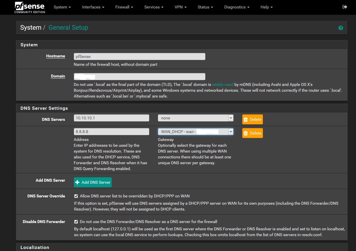

I have a feeling something might be screwed up in this region but i cannot put my finger on it. The first DNS is used with pfBlockerNG when active.
Who is 10.10.10.1?
It is a dummy DNS = No one as is not pointing to a Wan.
All DNS requests blocked by pfBlockerNG go here to die. pfBlockerNG is setup as a DNS based network AD blocker. So if it sees a request to or from a website on one of my lists it forwards those DNS queries to 10.10.10.1 which goes absolutely no where. Since the DNS queries cannot be resolved to a website the AD is effectively blocked.

I'm not exactly sure why you put 10.10.10.1 under General Setup, I always thought you'd have to put an external DNS server there which is will be used by the pfSense box.

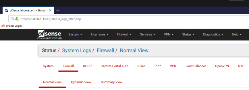

ok, what do your firewall logs say?

I don't do it that way. I put external DNS' under General Setup and then use firewall rules to block via the blacklists. Sites that are blocked are resolved to 10.10.10.1 and show a 1x1 pixel when tried via a browser.

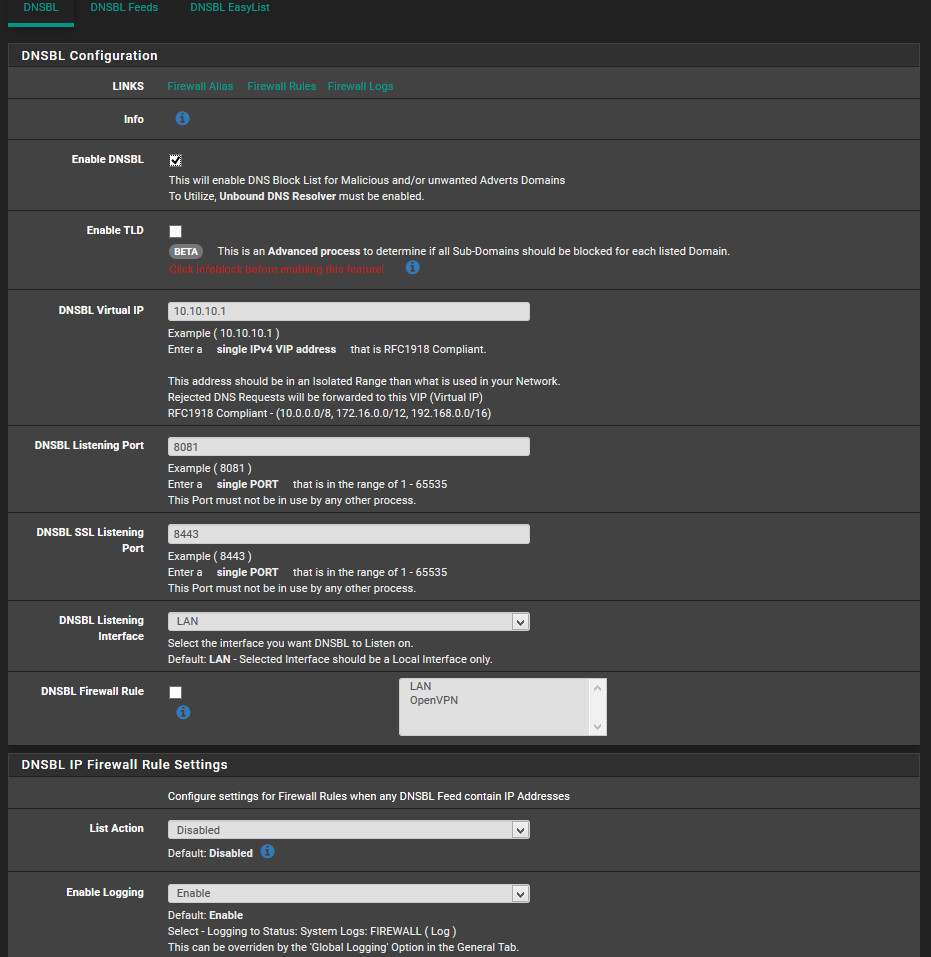

can you share your pfBlockerNG settings please, particularly the DNSBL and general tab.  I think your DNS servers are the problem
I use the same package and I don't have the pfblocker dns setting in my general/DNS page.  If I remember rightly, the only change you need to make outside of the pgBlockerNG pages is to ensure DNS resolver is enabled....
What happens if you change the DNS servers to OpenDNS (208.67.222.222/208.67.222.220) - can you ping?

Originally that is exactly what i had. The only reason that unfortunate DNS is even in here is due to the  "Reset your modem / router or try again later, or set your DNS Settings to 8.8.8.8 and 8.8.4.4 Also make sure that you have a Gateway address set up." message given at the fix common problems plugin. I was trying to give unRaid the most direct rout to the outside world.

I have not checked the logs. Honestly i am not 100% sure where to find them yet.

your settings page was the same as mine.  Don't know why you had the pfblockerng address in general - I just have a NAT rule that was auto-created that forwards anything to 10.10.10.1 to the designated ports.  https://www.fredmerc.com/2016/07/pfsense-adblock-using-pfblockerng-guide/  good guide

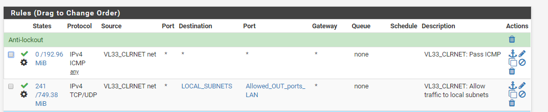

For the LAN/VLAN that your unraid server is on add a ICMP rule like this:

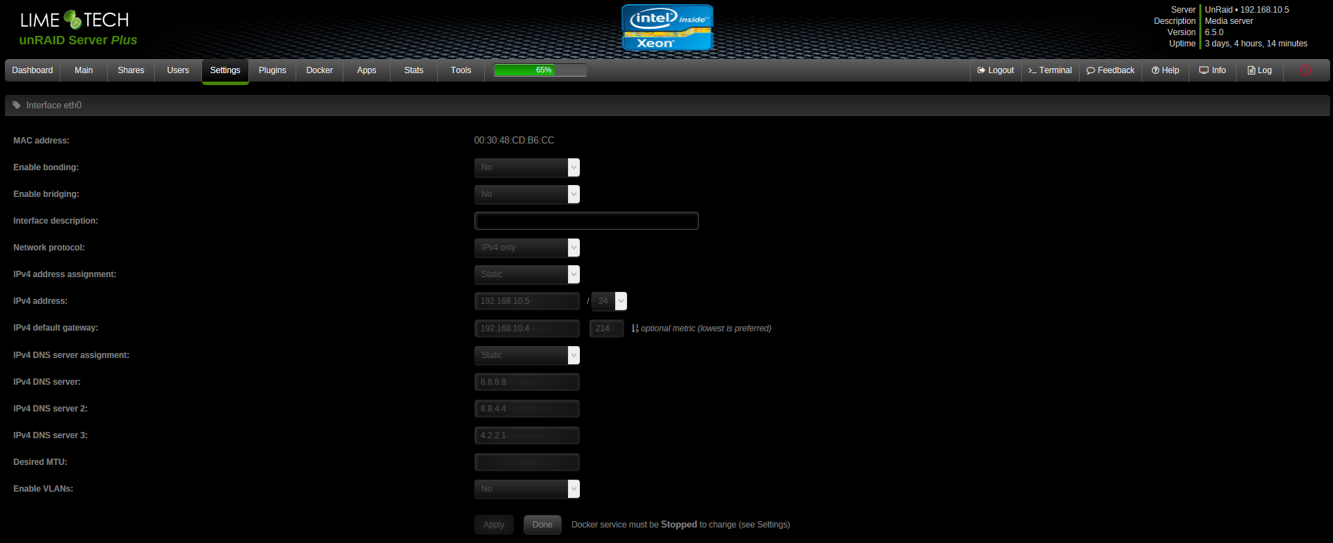

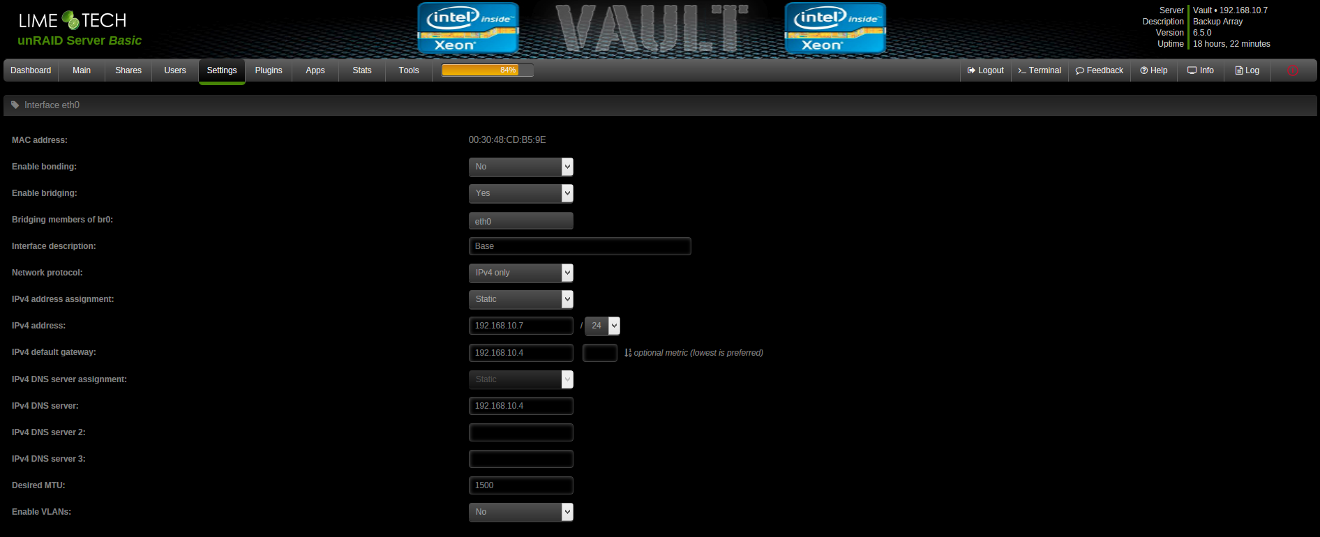

I have tested both servers and the Configs on both seem to not seem too make a difference.
5ab3c58f0f462_VaultNetwork.thumb.png.aa687c32b10e95fc9855bf5f91161f85.png5ab3c589ab167_UnRaidNetwork.thumb.png.b6ebf3b564413821ed4e70c353b4c338.png
why did you make your gate 192.168.10.4?
is that pfsense's ip?
Yes it is. Sorry i should have made that more clear.
have you seen my post about creating a firewall rule?
5ab3c4c550f4b_FireShotCapture73-woody.the-shepherds.com_-https___woody.the-shepherds.com_firewall_rules_php.thumb.png.37ae196f2e1dcfb0b5dd73dfdc036b2b.png
Hot Dang!!!!!!!!!!!!!!!!!!! This got both servers working.

where you can view logs
