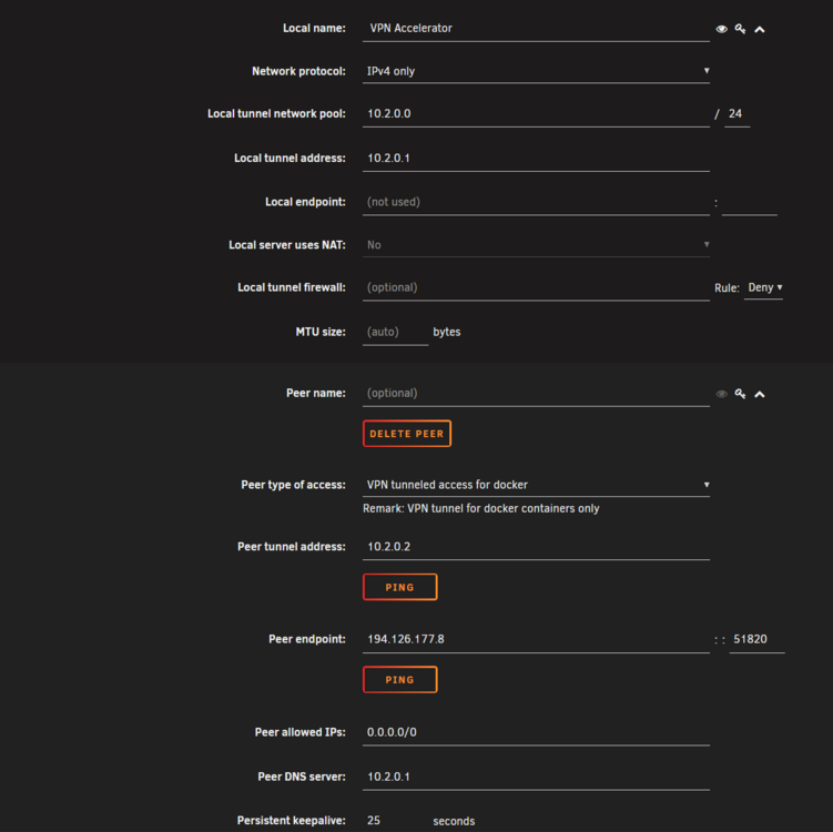

this is my vpn config:
I do mine a little different. Have you tried using pfsense to setup an OpenVPN path? With that in place, you can assign your containers IP addresses and route through whichever gateway you want.
