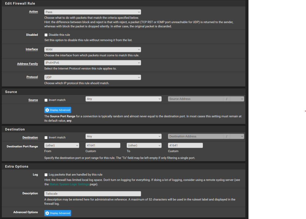

I forgot one thing, you might need to open up port 41641 UDP in your pfsense firewall.
I have more or less done the same thing by going to Services>UPnP, enabling port mapping and Allow PCP/NAT-PMP Port Mapping and creating an allow rule for the Unraid Server with a port range of 53-65535.
This is what the Tailscale Documentation recommends: https://tailscale.com/docs/integrations/firewalls/pfsense
Edited by Stubbs
It should do the same thing yes, for your server. But you have been trying to ping containers on a custom network and not the server so just humor me and open up port 41641 and see if that helps. Also, if you have Tailscale on your phone, try pinging the container from there on a mobile connection. And in the unraid webui under tailscale->status just to see if you get a direct connection from the server to the container.
