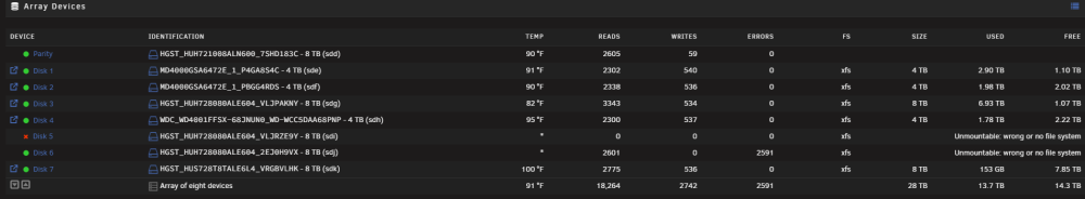

unmountable wrong or no file system and will not give option for Maintenance Mode
Up until today, I had my server limpng along (previous udma crc errors). I removed my SATA expansion card SY-PEX40167JMicron chipsets (JMB582/JMB575) thinking it was failing. I replaced it with a Supermicro AOC-S3008L-L8E (LSI 9300-8i clone). Once I was able to get the card to work through BIOS settings, I rebooted the server with errors.
I was going to try and go into maintenance mode and do the xfs repair however there is no option to go into maintenance mode.
Is there another way I can get Disk 6 back running so I can then deal with Disk 5?
My plan is to use unbalance to move all data from disk 5 to disk 7 and pull it out of the array and zero it out.
Any help is greatly appreciated.
In MAIN - Array Operation
Stop the array. Check the box for Maintenance mode. Start the array.
Better plan, check filesystem on emulated disk5 and on disk6, then rebuild disk5.
Your plan won't work as stated, some details missing. For one thing, you can't move any data from the unmountable emulated disk5, it won't mount without repairing the filesystem. Whatever you do, you can't remove it from the array without New Config/Rebuild Parity. And why do you think you want to zero it outside the array? Zeroing it while still in the array might make sense so you can remove it with New Config without rebuilding parity.
In any case, doesn't look like there is anything wrong with either disk, just connection problems. In fact, disk6 has disconnected and is now an Unassigned Device.

Stopping the array did not give me the maintainence option.
running root@Tower:~# fdisk -l /dev/sdl
fdisk: cannot open /dev/sdl: No such file or directory

Interesting. I ran the new diag before I rebooted and now Disk 6 has returned to sdj and it will let me choose maintenance mode.
After restarting the array in maintence mode, I selected disk 6 and the check file system status gives me this
Phase 1 - find and verify superblock...
superblock read failed, offset 0, size 524288, ag 0, rval -1
fatal error -- Input/output error
and it moved it to the unassigned devices again as sdl. I can mount it as sdl and all of the files are there. (diag 2)

Before attempting any filesystem check you need to resolve the issues with disk6, which dropped offline due to an apparent power/connection issue. Check/replace cables for that disk and post new diags after array start

Disk 6 is now back online and I ran a diag attached to this post.
After the diag, I went in and disk the Check Filesystem Status on Disk 5. It reported a dirty log. I zero'd the log (results attached) and restarted the array. Still has the red X but it did allow me to check and verify that the data was still on the drive.
