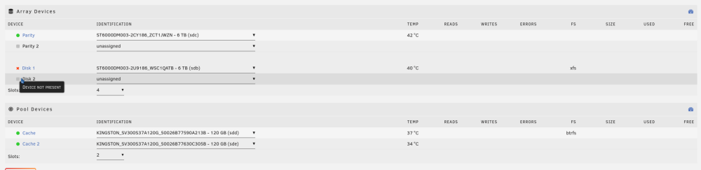

just turned off the array, and it shows disk2 is not even present? image.png
guess I'll have to move them around either way
Disk is disabled but present; you can try rebuilding again, I would recommend at least swapping bays first, in case the issue returns, to see it follows the disk or the bay.
