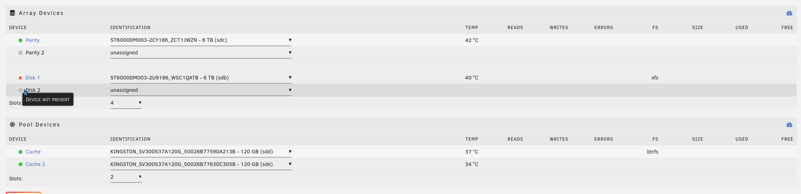

just turned off the array, and it shows disk2 is not even present? guess I'll have to move them around either way

They're in disk bays, and I don't know which one is which. Do you think it's safe to turn it off, switch the bay of both disks, and restart? Duno if that'll mess it up even more, changing locations.
