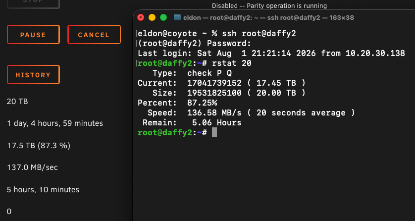

Not sure if anything like this exists already - never found anything in my brief searches a few years ago. Decided to post what I built - using info I scoured on these forums and elsewhere. Just wanted to share what I had - in case this helps anyone else.
The script uses information Unraid provides as updates in /var/local/emhttp/var.ini. The script is by now means complete and clean - but it gives me a fairly good idea of time to parity check/rebuild completion and/or current status. There's no clear error-checking either - consider this beta code at best. It does not write any data to any partitions - the worst it will do is provide inaccurate data.

If you pass a numeric value it will estimate the current speed and show a completion time - based on that speed.
root@daffy2:~# rstat 20
   Type:  check P Q
Current:  17041739152 ( 17.45 TB )
   Size:  19531825100 ( 20.00 TB )
Percent:  87.25%
  Speed:  136.58 MB/s ( 20 seconds average )
Remain:   5.06 Hours
Edit - The attached .txz places the script, named rstat, in /usr/loca/bin. I placed this file in /boot/extra/ so it is loaded into Unraid filesystem upon each boot. Not sure if this is the best approach. I'm open to ideas - but this seems to work great for me.
