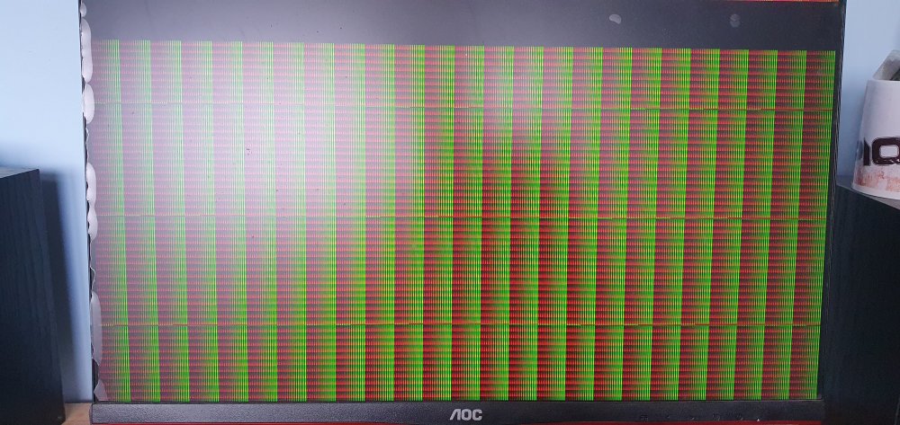

I have recently swapped from a gt970 gpu for an AMD Radeon RX 9060 XT. However, I am having issues getting it passed though. Normally, I would bind the gpu to boot, select it as graphics including the sound and then start up the vm. Except it does not work. I have tried dumping and using the vbios, Disabling frame buffers and using video=efifb:off modprobe.blacklist=amdgpu all which have no effect. The VM does start fine but I see in display on windows 11 settings as AMD Vdisplay and not my normal display. When I do turn on my display, its looks very glitchy and strange as per my image attached. it is not a cable problem or anything as the display port cable is plugged directly from the gpu into the monitor. i have also tried hdmi as well. Sometimes i do get the following error message, when booting the vm. If i boot normal bare metal, then everything works fine without issue. But boot as a vm, this is where the problems start, so there is no hardware problems. This is the only gpu in the system which is also what unraid uses and I have tried running,
