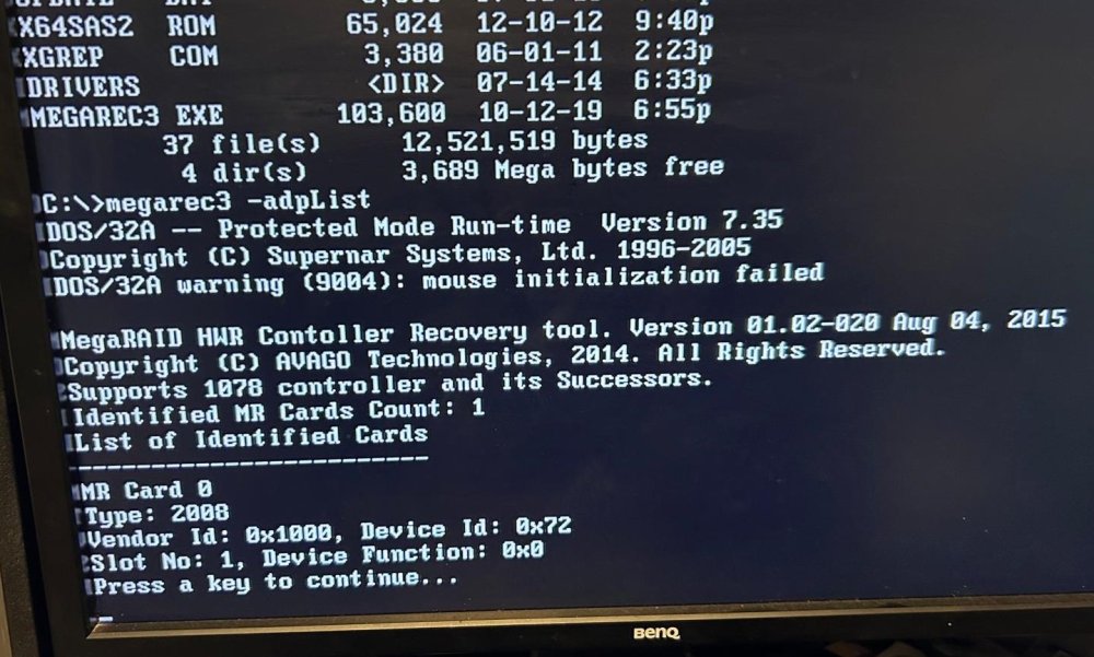

Last I used Megarec3 -adpList it showed - Identified MR Cards Count 1
MR Card 0
Type 2008
Vendor ID: 0x1000, Device ID: 0x72
Slot No: 1, Dev Function 0x0

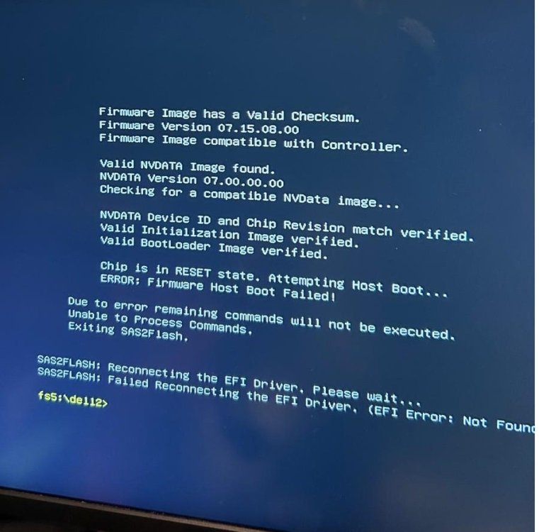

I only have two photos both which show what i've said.

It is still getting to Mfg Page 2 but not able to validate. These are the images from attempting it. Two diff efi, one which supposedly was meant to bypass the mfg completely
but still doesn't.
The controller has its green light flashing too which it didn't have before.
Thanks for the screenshots, they help a lot.
Both flash tools accept the P7 IT firmware without problems. The image, NVDATA, and chip revision checks all pass, and the firmware host boot succeeds. The failure only happens when the tool writes the manufacturing settings to the card's NVRAM and reads them back: "Failed to Validate Mfg Page 2", then a firmware fault.
So the card can run firmware in its RAM but can't store and verify data in its own non-volatile memory. It also reports a FAULT state before each attempt. You confirmed that it showed "not operational" before your first erase, and it was already detecting disks only intermittently. I think a hardware problem with the card is now much more likely than a flashing mistake. A different utility or firmware version is unlikely to change this.
I would stop spending time on this one. An HBA already flashed to IT mode (for example a 9211-8i or 9207-8i type card, or an H200/H310 sold as IT-mode) doesn't cost much and is the quickest way forward. Once it's installed, Unraid should see the disks directly, with no flashing needed.
If you want to try one last thing first, test the card in a different PCIe slot, with no disks connected and no other add-in cards installed. But I wouldn't expect a different result.
