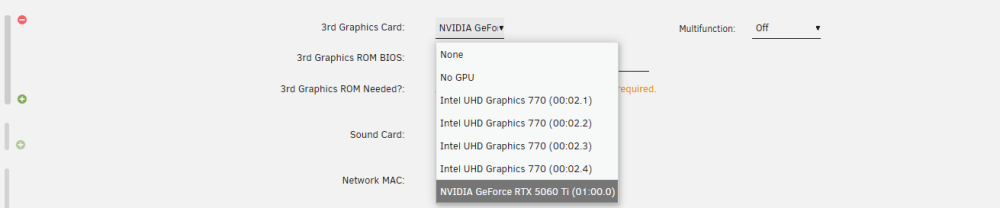

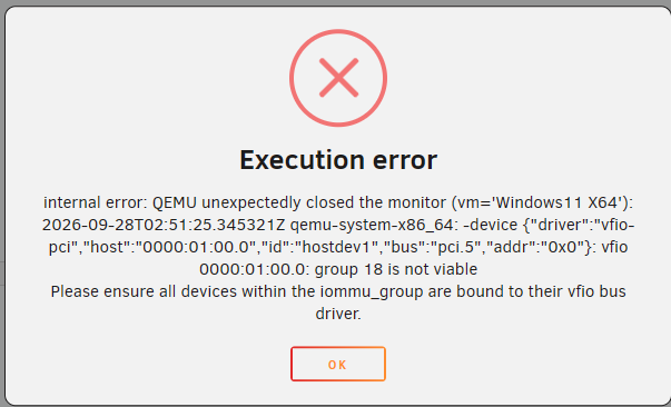

Unraid7.3.3-rc2 graphics card direct connection, virtual machine startup error
Equipment:Z790+5060ti
OS: Unraid7.3.3-rc2
The configuration details of virtual machine Win11 can be found in the XML file. In Unriad7.3.2, everything is working normally. When upgrading to Unraid 7.3.3-rc2 or Unraid 7.4-beta3, the virtual machine starts with an error. How can I solve the startup error? Background: Z790+5060Ti, for virtual machine Win11, simply connect to the Nvidia sound card. After turning off the virtual machine Win11, Unraid's webui freezes and spins, causing a malfunction in the virtual machine's functionality. It can only be shut down by forcibly pressing the switch. Therefore, physical sound cards cannot be used, only virtual sound cards can be used

Thanks for the diagnostics. The VM log shows the cause:
vfio 0000:01:00.0: group 18 is not viable. Please ensure all devices within the iommu_group are bound to their vfio bus driver.

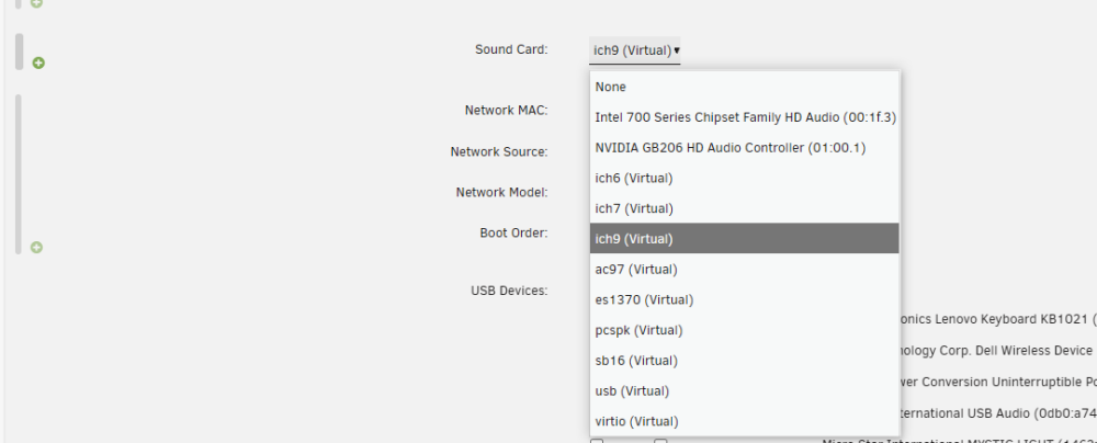

Your 5060 Ti's graphics device (01:00.0) and its HDMI audio device (01:00.1) are in the same IOMMU group. The VM passes through only 01:00.0. The audio device stays with the host sound driver, so VFIO will not start the VM. This is a configuration problem, not a 7.3.3 regression. Most likely your 7.3.2 setup still passed the NVIDIA audio through.
You can keep the virtual sound card. Do one of these:
1. Go to Tools > System Devices. Check only the NVIDIA audio device (01:00.1, 10de:22eb), click Bind selected to VFIO at boot, and reboot. The GPU can still move between the host and the VM.
2. If you don't need the GPU in Unraid or Docker, bind both 01:00.0 and 01:00.1 to VFIO at boot and reboot. This also avoids a known NVIDIA driver problem when the GPU returns to the host after the VM stops. That problem is a likely cause of the WebGUI freeze you had after shutting down the VM with the NVIDIA sound card passed through.

I need to use an Nvidia graphics card in Unraid and Docker, and the virtual machine can be directly connected to the Nvidia card. The virtual machine can start normally. What should I do next? Thank you
