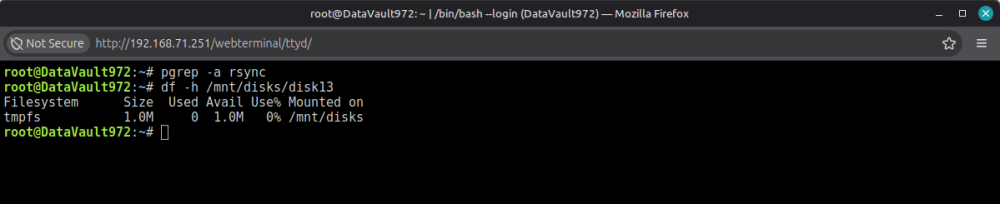

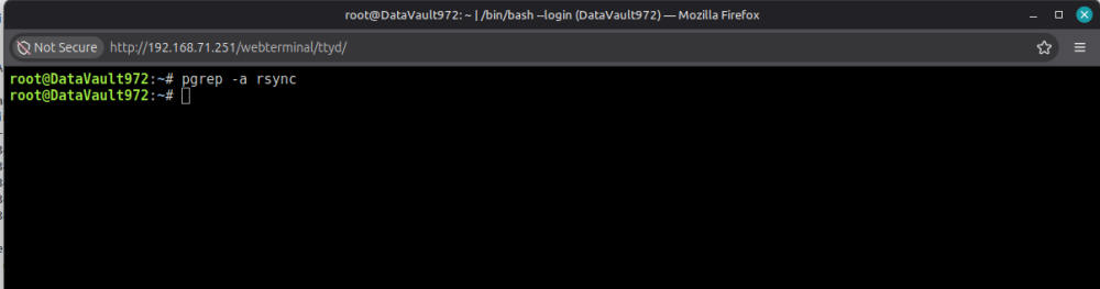

  1. When I ran the pgrep -a rsync command, I got the below response, which indicates that the copying is done.Screenshot from 2026-10-11 10-53-31.png
  2. When I ran the df -h /mnt/disks/disk13
    It showed that my drive size is 1mb, could this mean that my drive is not formatted yet?Screenshot from 2026-10-11 10-53-51.png
  3. Additionally you mentioned that I can check on the main page, however, how will that work if I have not started the array due to the fact that when I try to add the 2 22tb drivce (one for parity and one forregular) in the Array operations section, it states that, " You may not add new disk(s) and also remove existing disk(s)." Should I put "No device" in the parity drive and then start the drive with the 2nd 22tb drive?
You're right, the 1 MB means the new disk was never mounted, so the copy did not run. Unassigned Devices puts a small 1 MB RAM area on /mnt/disks. When a disk isn't mounted at the name you use, the copy goes into that area, fills it, and stops right away. Nothing was lost, but we need to redo the copy.
