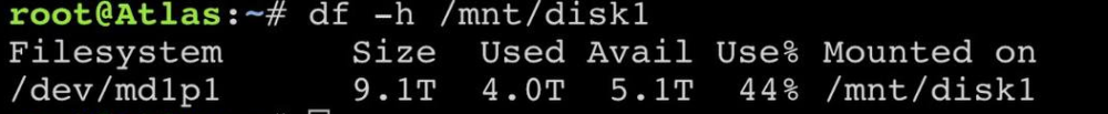

I have had a disk die - (disk1) so I proceeded to move everything off it to other disks in the array as I cannot afford a new drive currently, this completed but after it did, the emulated disk showed 4TB still in use. I had started to troubleshoot this but didn't get far as I had to go out today, I did manage to get a screenshot showing the usage below, despite there being literally nothing on this disk when looking into it:

I then checked other docker containers and half are not running, half are, but cannot be used. So I am suspecting some docker image corruption perhaps... I then just thought let's reboot the server to see if perhaps the disk1 usage thing clears and it maybe fixes the issue if some paths are looking at disk1. When it came back up, disk1 started to show "Unmountable: wrong or no file system" I stopped the array and started it again, with disk1 still in but same issue. I am wondering if I should replace the cable that disk6 runs on and then create a new hardware profile with all the drives moved up 1 so I can then scrap disk1 but I am a little worried with the docker issue on top and wanted to run it by you guys before I likely make anything worse! I've also attached diagnostics as it currently stands.
