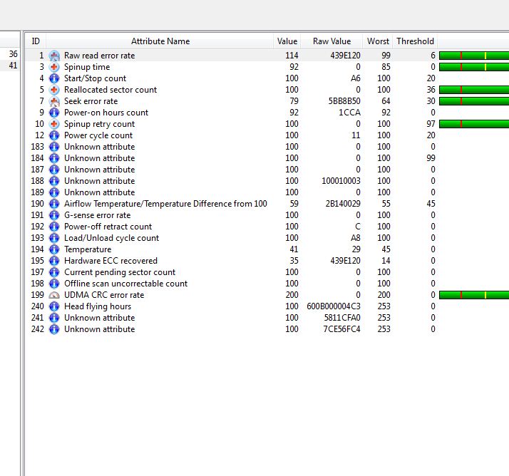

Attached is a screenshot of the Smart Data.
It all looks ok to me.
I had a similar issue with a Seagate 1 TB earlier. I replaced it with this 2TB and all has been fine so i assumed it was the drive, however it now looks it might be in the system
Can you please check the smart data and verify is there is a problem with the drive?
Drive looks perfect.
