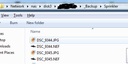

Issue is, it appears to be ignoring that data and writing to the wrong drive.
For example, I have a share for my machine backup that uses M$ synctoy to backup my user directory.  I have it assigned to disk 1, excluding disk 2,3.  It's currently writing to both disk 1 AND disk 3.  As well, when browsing to \\unraid\sharename, I see the data from both disk 1 and 3, further proving it's using both drives for an unknown reason.

If the share exists on an excluded drive, directory listings will still include the files on that drive. It's my understanding that writing to the share will exclude the specified excluded drives with the exception that if you have a split level and the split directory is on the excluded drive, it will still write to the excluded drive.
