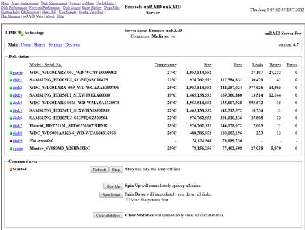

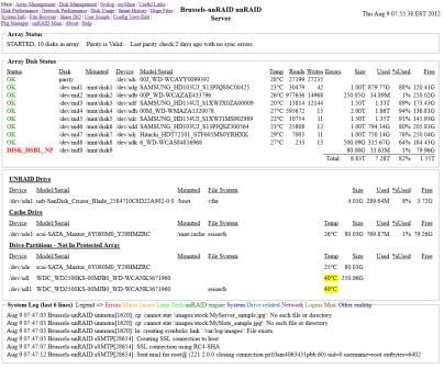

OK a bit of an update and a plea for a little more guidance please...
I have run reiserfsck on md2 which instructed me to re-run with the --rebuild-tree switch. Done that and recovered 3 files, moved them into the array using MC... great! It now appears that I am not getting the file system errors... great again.
Now back to recovering the missing data... I have the old disk2 mounted outside the array, should I simply copy the contents to /mnt/user and hope all comes back even though (from what I can see) not all missing data is on disk2?
The other thing I have noticed... which is odd to me... is that disk2 (which was a 250Gb replaced by a 2Tb - which is where this mess started) is being reported by the unRAID Main menu as 2Tb but by unMenu Main as 250Gb... strange  :-\
Could someone please give me some more pointers on recovering the data... after the success of reiserfsck and reading other posts I'm semi-confident that it can be done but concerned I'll make matters worse without some Hero guidance.
Thanks in advance
syslog-2012-08-09.zip
