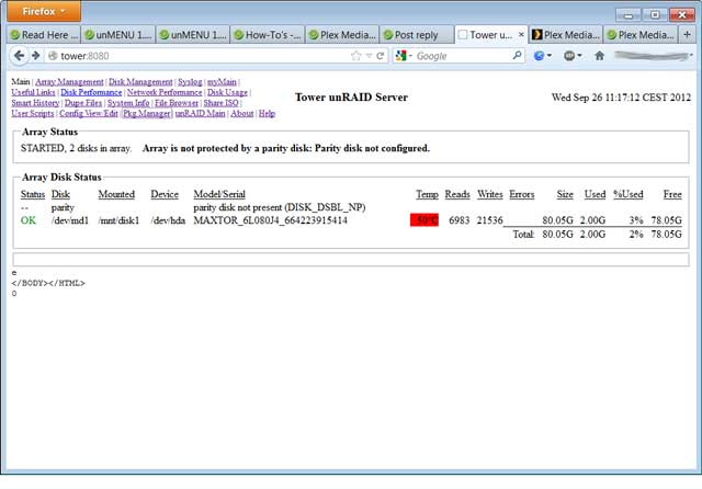

In the meantime I try to get menu to work. It works fine following the wiki, but after a reboot I have to manually start it with ./uu
But inside /tower:8080 every link in the top-menu is empy, exept the main page with disk info.
If I try the pkg manager the page is blank. Folowing the wiki to tryinstall "screen" but since everything inside is blank, besides this:

It looks like DNS is not configured. Look in Settings->Network Settings
Yes, it is set, and I can ping outside www adresses.

It is expecting /boot/packages and /boot/unmenu to be persistent.  Apparently, in your config, they are not and the files are probably being written to RAM. (and are gone once you reboot)  You must mount the flash drive at /boot

What do you see when you type:
ls -l /boot
and
ls -l /boot/packages
and
mount
and
ls -l /dev/disk/by*
One more thing, your disk temperature is in RED because it is way too hot.  Most people try to provide enough air flow across the disk to keep its temperature below 40C.  My disks typically sit in the upper 20's to mid 30C range.

Hi, and thank you for your reply.
The strangest thing is that after a number of reboots, without doing anything, everything is now working fine.
A lot of packages is listed.
Thank you for the heads up about the temp. My fan in front of the disks was not connected, and now it is just above 40C.
