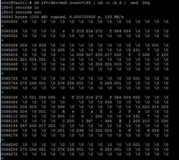

Very Important... The ADDRESS to fix is different on /dev/sde vs. /dev/md3.  md3 is the first partition.  We would need to run the original "dd" command on /dev/md3, find the "R eIs E r 2 F s " and then calculate the address following the end of it + 3.
like this:
root@Tower:~# dd if=/dev/md3 count=195 | od -c -A d |  sed  30q
195+0 records in
195+0 records out
99840 bytes (100 kB) copied, 24.1886 s, 4.1 kB/s
0000000  \0  \0  \0  \0  \0  \0  \0  \0  \0  \0  \0  \0  \0  \0  \0  \0
0065536 376  \v  G  \a  ( 270 033  \0 023  p  \b 005 022  \0  \0  \0
0065552  \0  \0  \0  \0  \0      \0  \0  \0 004  \0  \0 253 001 357  E
0065568 204 003  \0  \0 036  \0  \0  \0  \0  \0  \0  \0  \0 020 314 003
0065584  "  \0 002  \0  R  e  I  s  E  r  2  F  s  \0  \0  \0
0065600 [glow=red,2,300]003[/glow]  \0  \0  \0 005  \0 217 016 002  \0  \0  \0 325  Y  \0  \0
0065616 001  \0  \0  \0  3 214 357  D 373 256  A 360 256  K  v 006
0065632 020 206 321  j  \0  \0  \0  \0  \0  \0  \0  \0  \0  \0  \0  \0
0065648  \0  \0  \0  \0 020  \0 036  \0  m 262 303  M  \0  N 355  \0
0065664  \0  \0  \0  \0  \0  \0  \0  \0  \0  \0  \0  \0  \0  \0  \0  \0
Looks like it is at address 65600 on the /dev/mdX partition.  (Note the value on my array's disk is a 003.  On your drive that will not mount, that byte is a 000.  Once changes to a 003, since there are no other reiserfs errors, it should mount)

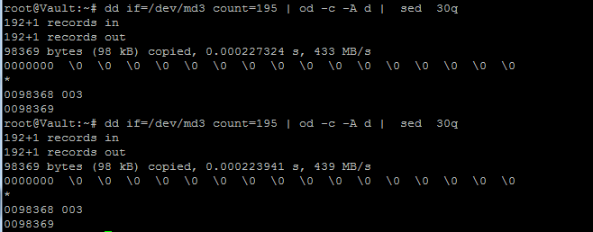

Oh my what a day. I ran the diagnostics. Every drive passed. (good news I guess).
I went ahead and found a "config" folder backup from 10/2/12 of my unraid drive. I like to back it up every so often.
I removed all unraid plugins from my flash drive, and restored the Super.dat which had the old drive configs. (I am sure this isn't the best way to do it, but it go rid of the redball on MD4 and let my use my original 2TB drive for MD3).
Now I that I had a "working config" I was still seeing MD3 as unformatted.
This is where I screwed up I think.
I ran: dd if=/dev/md3 count=195 | od -c -A d |  sed  30q
echo -ne "\0003" | dd bs=1 count=1 seek=98368 of=/dev/md3
I think that command might have only been for /sde vs /md3
Now when I run dd if=/dev/md3 count=195 | od -c -A d |  sed  30q it looks completely wrong.
Screenshots attached.
1st screenshot is before
2nd is the command I ran
3rd screenshot is after
You are correct... those commands are for use on the /dev/sde device, not the /dev/md3 device.
You overwrote one byte, somewhere... with a 3.  Did you run the prior command I supplied to see the initial contents at that same address?  If you did, we can just put it back.
I did post the correct offset for the /dev/md3 device...
Looks like it is at address 65600 on the /dev/mdX partition.  (Note the value on my array's disk is a 003.  On your drive that will not mount, that byte is a 000.  Once changed to a 003, since there are no other reiserfs errors, it should mount)
However, since the disk is attached to the /dev/md3 device, you can just run
reiserfsck --rebuild-tree /dev/md3
and it will fix it too.  (no need to just fix the one byte, since parity will be in sync if the /dev/md3 device is used for the --rebuild-tree)
Something still looks odd.
Your "R e I s E r 2 F s" string is at a different offset than I predicted.  I would have expected it to the at the same relative position in the /dev/mdX devices, regardless of the starting sector of 63 vs. 64.
First I ran:
dd if=/dev/sde count=1 bs=1 skip=98368 | od -c -A d |  sed  30q
Then I ran:
echo -ne "\0003" | dd bs=1 count=1 seek=98368 of=/dev/sde
Then I ran again:
After that I stopped the array and restarted it. The drive showed unformatted still. I stopped the array and restarted the computer. I then started the array and still had no luck
Then I ran dd if=/dev/md3 count=195 | od -c -A d |  sed  30q
then
then
So I should only need to run
reiserfsck --rebuild-tree /dev/md3 and that's it correct? I am not typing anything else until I hear from you again :) My impatience is my own undoing at times I swear.
Its odd, I thought when I setup my array for my WD EARX drives I precleared them with -a vs -A. So I'd assume it *should be* on 63? I think for some reason it's thinking its on 64?
