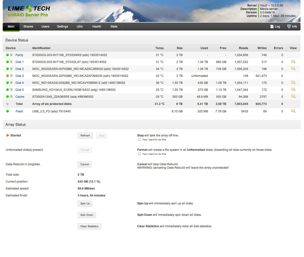

So I had a WD 2TB drive redball on me. I went out and bought a new 2TB WD EARX. I pre-cleared it in another computer. Pre-clear passed.
I pulled the bad drive out of the norco 5-in-3 and put the new one in its place. (The array was stopped at this point).
I assigned the new drive to disk3 (which replaces the bad disk3). It started the data rebuild which took 7hrs or so overnight. When I checked it this morning my drive still shows as unformatted, but its green.
What do I do next? I really don't want to lose that data.

While I don't know much about system repair, It says in the Array Status potion of your embedded screen shot, that "Data rebuild in Progress' and that it has another 4 hours, 55 minutes to go before completion.  Why don't you wait until that process is completed and then report back.

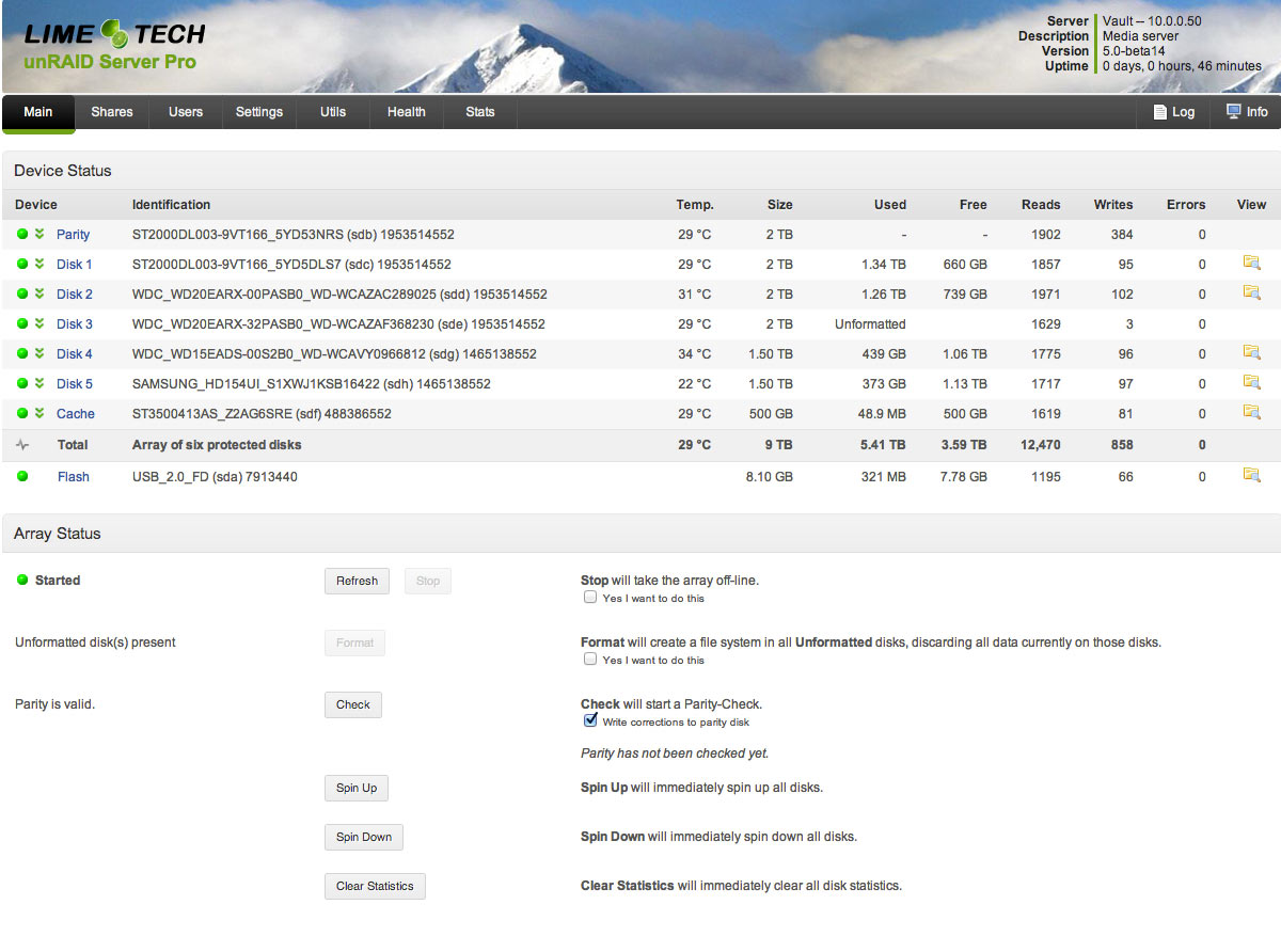

That screenshot was from last night. It is 100% done now and looks like this:
(see attached)
Unfortunately, unraid presently doesn't really differentiate on the status screen between genuinely unformatted and just unmounted. It's possible that if you just do a clean shutdown and restart the array, it might come up ok.
First make sure any add-ons are disabled, capture the syslog now, do a clean shutdown, start the machine, wait for it to comepletely finish starting, capture another syslog, and post both syslogs here.
I did capture the syslog before the reboot and posted it in OP.
I then rebooted and took the screenshot in post2. I can attached a syslog of current if you'd like.
