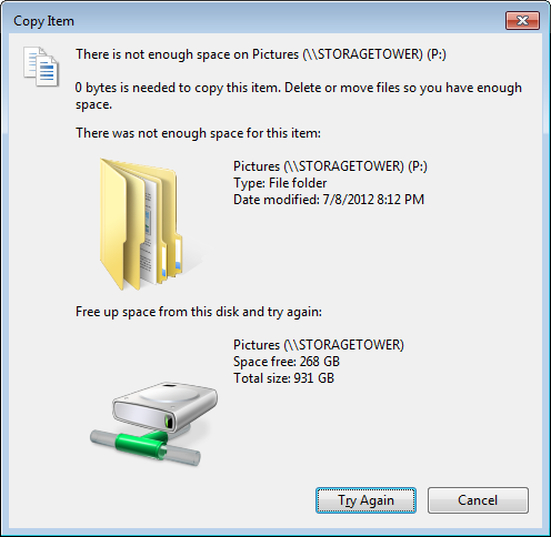

I have been running my unraid server with no problems and suddenly today when i went to create a folder on my pictures share it tells me i dont have enough free disk space to do so.  see the attached screenshot.
This was from a windows 7 system.  there is 268GB free on the share so there shouldnt be any problems with disk space.  Can somepone tell me how to troubleshoot this?

Ok so I think I discovered the problem.  There were two discs (disk1 and disk3) that were full.  But the shares that contained those disks also contained other disks.  so windows was displaying that there was free space on the share (on the disks other than 1 and 3), but was having trouble writign because those discs were full.
So I cleared some space on the full disks and it works now.
But now what I am wondering is why that happened?  Windows should have been able to write to the share and have it go to the disks with free space.
