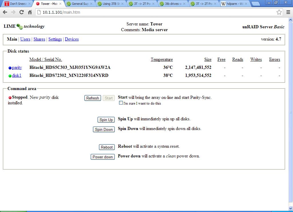

Few days later i have got a hitachi 5300 3tb drive with warranty to replace the parity disk.
I am going to update to the v5 rc8a unraid distro.
after stopping, upgrading linux, booting up, Im reasearching but it looks like I map the new 3tb as the parity.
And here's the next step I havent found info on yet,  how do I rebuild the parity?  Does it do this automatically?
On a side note I found the profile settings,  the classic rock avatars jam!
thanks for the good advise ,  once I get the parity up and running I'll work with the "bad" drive.  Im leaning towards an os failure trashing it but will see.
Well 5.0 with 1 drive assigned was a failure. Backed up to 4.7 successfully.
Anyone have a tip on how to resize the 3tb drive with 2 2tb drives plugged in?
Do i need to un assign and un plug the larger drivers to run a hdparm -N xxxxxxx ?
The data on that one drive is critical.
im about to hdparm -N p4294963168 /dev/sdX will this know to partition the 3tb.
Im trying to avoid partitioning the good 2tb, its installed and running in the same case/unraid.
how about blue and the size is right.
