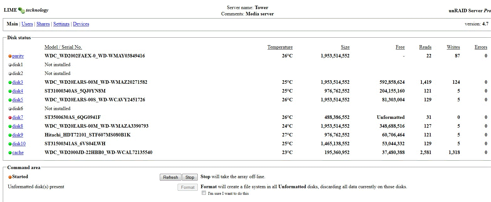

I'll try to make this short. I recently moved and was extremely careful of my server when doing so, as I always am. I left it unplugged for about 3 weeks. I plugged it in two days ago and stared to watch some shows. I checked the unraid interface and everything was good (all green). Last night I checked the interface and saw my parity drive red and disabled. I tried to update the parity but when it tried I just got tons of write errors and then it would give up. I decided to power down and check the cables. Powered up and one of my other drives went missing. Powered down got that drive back but lost another.
Long story short, I now my parity drive is invalid and a data drive is now showing as unformatted.
Question is, now what do I do? Is the data still on the unformatted drive?
I've attached some of my system logs. One had a lot of repeating unimportant data so I trimmed it. Currently the server is powered down at home. I can get a current log when I get home and post it
syslog-2012-10-23.txt
syslog-2012-10-24.txt
Here's the current status of my server. Parity invalid and disk 7 unformatted. I bought new cables and installed them on disk 7 and parity as a precaution.
Attached is my syslog from start up till now. Current status of unraid's main page and the smart report for my parity and disk 7.

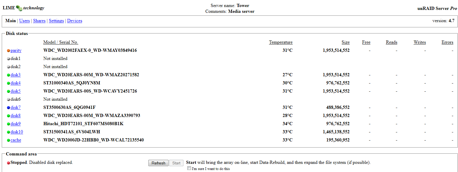

I also just bought a 3TB drive, assuming I can't trust my disk 7 any logger and feel a little unsure with my current parity. But the thing is:
A) this is my first and only 3TB, so it will have to be parity.
B) I'm on 4.7.
Is it possible for me to assign the 3tb to parity and unraid only see and use 2tb? I do plan on upgrading to 5.0 relatively soon but not right yet and I have no other 3tb so I don't need my parity to be any bigger then 2tb anyhow.

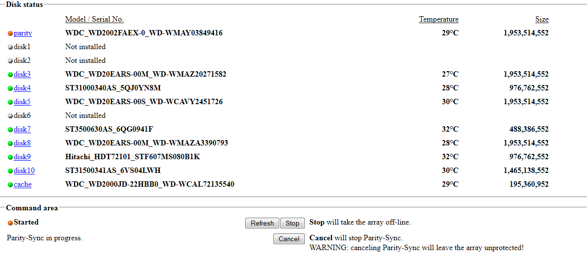

Added the drive back on my primary server in the same slot. Ran initconfig and its now building parity! I don't know what the hell went on. I guess somethings got loose during the move. Any tips to enure everything it in tip top working order? I assume just run a long SMART test on all suspect drives??
EDIT:
Not quite yet. I can't catch a break. Looks my disk3 is throwing out a ton of read errors. syslog was too big to attach. It's full of:
Oct 26 01:17:09 Tower kernel: handle_stripe read error: 112728728/1, count: 1

EDIT2:
Solved, checked my disk3 with reiserfsck everything was fine. So I ran initconfig and started up the array.
