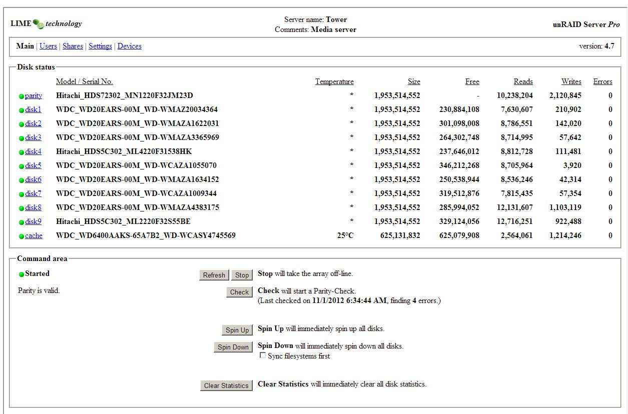

Sorry to reply to my own post, but I think something changed without me doing anything.
When I started this thread my unraid menu screen was showing that it had completed it's regular monthly parity check and found four errors. I can't post an image of the screen at that time because it has changed but it had a line called something like "Sync errors" and showed the number 4. I posted about this situation and was waiting for some guidance from members.
I just went back and looked again at the unraid menu screen and it shows a different summary that says "Parity is valid" and that it last finished checking parity at 6:30 this morning and found four errors. (image of unraid menu screen attached)
Did it correct them? I certainly didn't run a second check with a "CORRECT" option, just the monthly parity check.
Further evidence: on the "Disk Management" page it says: "Parity is Valid:.  Last parity check < 1 day ago .  Parity updated 4 times to address sync errors."
I'm just confused. Do I currently have valid parity or do I have current errors that need to be addressed? If my parity is now valid how did it get so, as I believe the monthly check has the NOCORRECT option.
