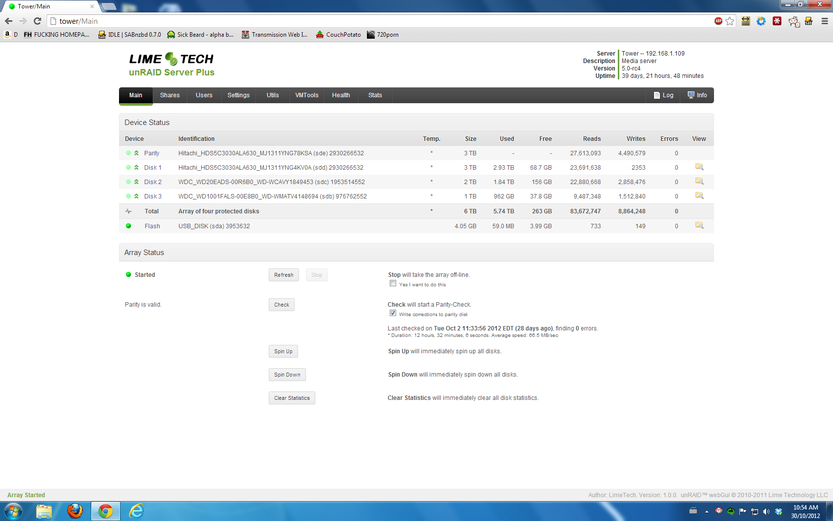

So the monthly parity check of October 2nd finished fine without any problem. But the one of this month (Nov 2nd) made my unRAID unresponsive:

The webgui on unraid 5 CANNOT be restarted, your only option is a reboot. If the webgui has died due to a memory issue then you can make some settings to avoid that happening again (search for OOM_ADJ in the forum)
