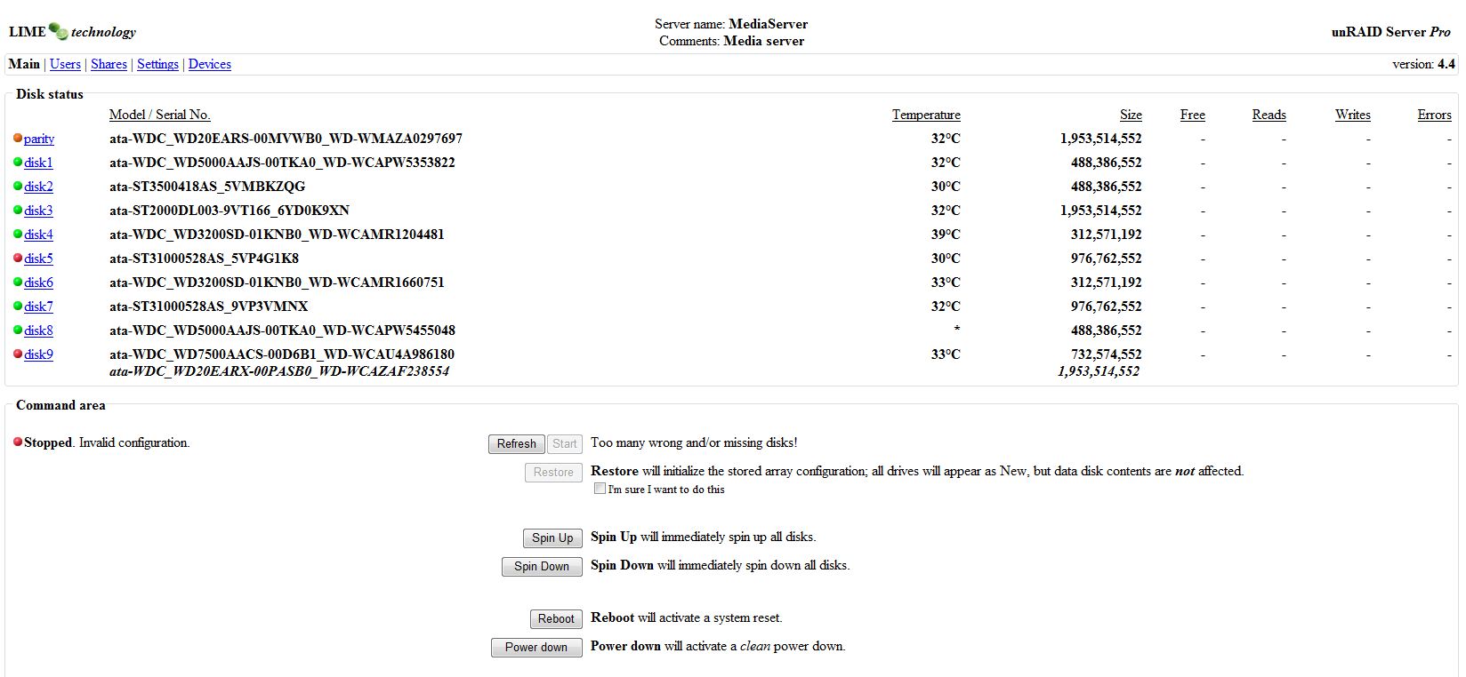

So I Put the original drive back. I got three drives colored some other color (I am color blind - I really wish Unraid would use a square, triangle, and circle icon to help us).  See attached screen cap.

In regards to the raid array. I THINK I must tell it to re-store the array, now that I have all the drives back and online. The data has not changed since I started this debacle so I am not worried about losing changed data.. but I don't want to lose the data.
New_Text_Document_3.zip
So given that all my drives are back to the way they were, and given the information in the screen capture... is this one of the few instances where I should select "yes I am sure" and tell it to restore the array?
The overall plan is to put the original drive back in (which I have done), get the array working perfectly once again, then upgrade to the latest stable version, THEN try to replace that drive that had been giving me problems.
sound good???
You can do that if you are sure all the drives are healthy. That will invalidate parity and start a parity build.

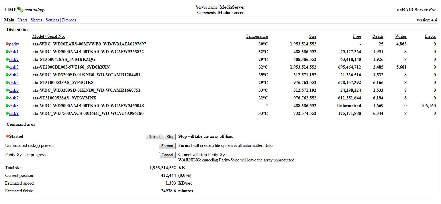

ok that got me back to where all the drives are found as they should be... A parity check is running but I STILL have one unformatted drive...
Can I upgrade to a newer version in this state? I read the newer versions don' thave as much of a problem with the unformatted drive issue.
Can I force the drive to mount? then restart the parity check?

You have a bunch of errors showing on that drive. Something is wrong with it. A syslog might help diagnose the issue. You could also try shutting down, swapping the power and SATA cables and booting again.
attached is my new log. you are right, drive 8 has mucho errors. I tried changing the cables but no luck. It is interesting that the drive shows as unmounted and not just dead...
assuming drive 8 is dead.. I have one dead drive and an invalid parity drive. What are my options... I thought of letting the parity sync finish.. not sure that is a good idea... not sure it will even finish.
So what do I do next? I assume I lost data.. but what do I do next to get back to some type of normal.
