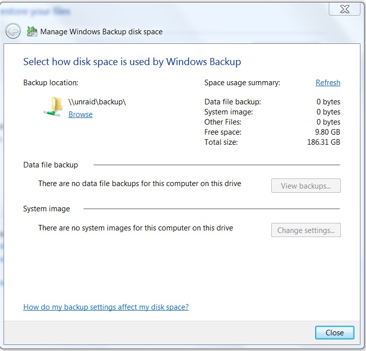

While trying to manage the backup from my laptop to delete older backup sets I see information in the attached file.

From this screenshot of the Windows backup, it is saying that this particular computer does not have any backups stored out on the server.  You mentioned computers in your first post.  Look at the same screen for each of these computers and do the math on ALL the numbers.  I assume that you can manage the backups for the other computers that you are using this system for.  (From what I can see, you can only manage the backup files for THIS computer from the Windows Backup software.  You will have to go to the other computers to see what they are doing.)  If the other computers are are backed up to the server then the issue lies within this computer.

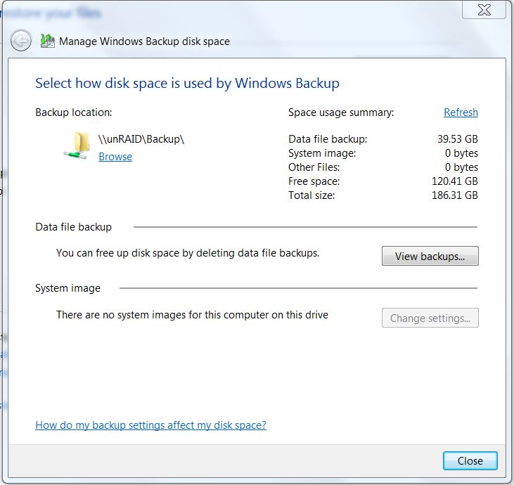

I back up two laptops to the unRAID server. I checked and can't manage the Windows 7 backup from my wife's laptop either.  Same problem as my laptop. See attachment in this thread.
