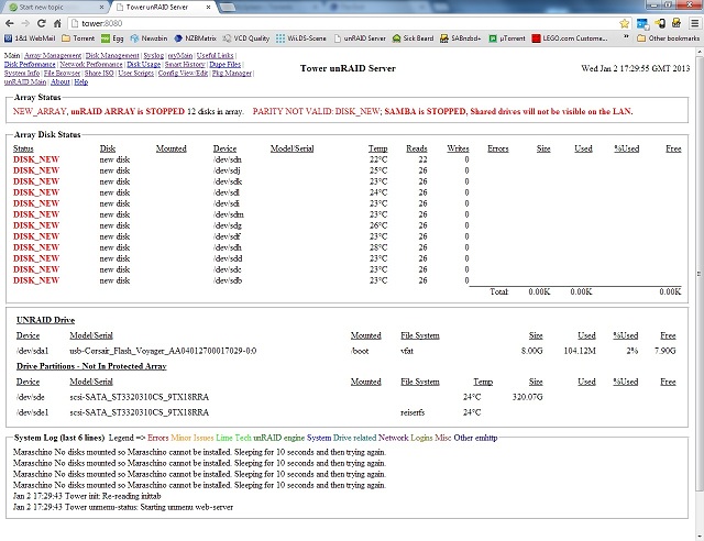

All Disks showing as new
My tower was rebooted and following the reboot it said SAMBA is STOPPED, Shared drives will not be visible on the LAN, I read somewhere some advice to delete the /etc/samba/private/secrets.tdb file and it would be recreated.
Whether this was a good idea im not sure but i mv it to /etc/samba/private/secrets.bak so as it to be backed up and being able to restore later, or so i thought as after rebooted the file is re-created but my .bak has gone.
Anyway situation now is that all disks are showing as new, see attached screenshot and syslog, can anyone offer any advice as to what happened or my options for recovery? I assume that the contents of my files are all ok on the invividual disks.

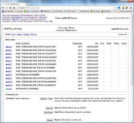

See my sig to disable all add-ons.  Show an image of the stock unRAID main page.
I took the usb flash disk out and plugged into my PC but there is no /config/plugins folder? There is a /packages folder in the root of the USB
There is also no /extra folder either.
I dont quite understand what use the stock go file means?
If I click the unRAID Main option from unMENU is this teh page you wanted to see? if so its attached.

The stock go file is shown in my sig. Start the array. DO NOT click anything else. Are the disks mounted correctly or do they appear as unformatted?

Everything looks fine.  you might want to perform a checkdisk/scandisk while you have the flash drive in your PC.
For all the drives to be "blue" it is as if the config/super.dat file is corrupted, or missing.  (or, you typed "initconfig", responding with "Yes" and you set a new disk configuration)
When you next start the array, parity will be initially calculated, as if it is a new disk configuration.  All your data should be fine.
HOWEVER... there is a bug in the 4.7 unRAID where when a super.dat file is missing, the disks get their MBR re-written based on your current preferences  (4k-alligned, or un-aligned).    If you start the array and all (or any) of the disks show as unformatted DO NOT FORMAT THEM.  You may need to point their MBR back to the correct partition start.  (The data is still there, but you are not pointing to it properly, therefore the disk cannot be mounted, and appears unformatted in the display.  It really is formatted, just not mounted properly)

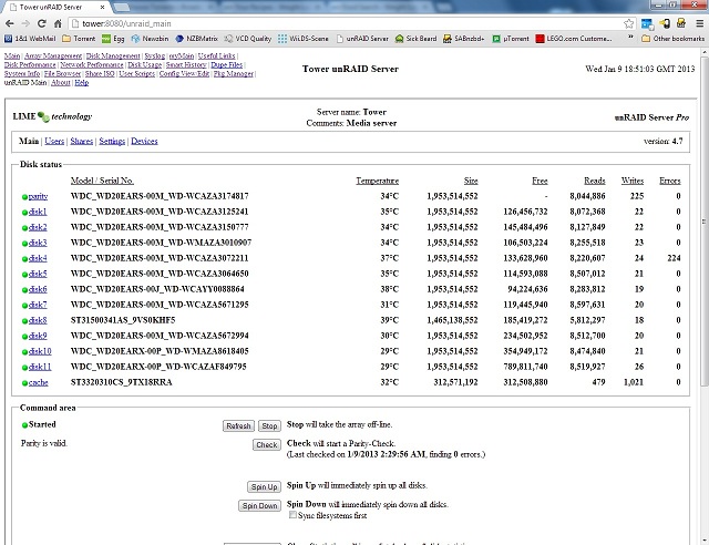

Just noticed those errors against disk4 as well, should i be worried about those?
Yes, there should only be zero errors. Post a SMART report for disk4.

  1 Raw_Read_Error_Rate    0x002f  049  049  051    Pre-fail  Always  FAILING_NOW 164785
are not good news? Time to change the disk?

Replace drive ASAP. It is dead.
It is definitely  time to replace that disk.
