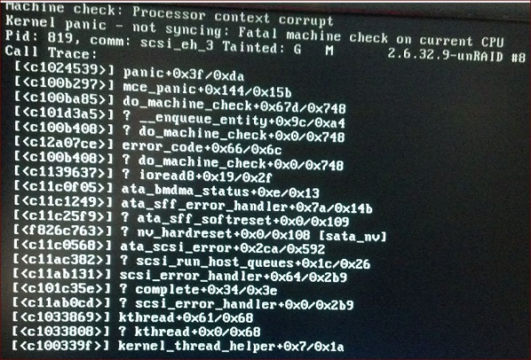

I am running unraid server 4.7 for over a year with no problems.  Problem just started and now see issue when i plugged monitor in (usually just use Putty but it wouldn't connect).  The attached pic shows the issue and when looking for problem in forums it appears to be hardware. I just don't know how to go any further with debugging since it locks up with this screen after i get to the Root Login prompt.

I would start by running memtest for a night to rule out any memory errors. The error mentions scsi, as well as "ata_softreset" and "nv_hardreset", so it is getting a kernel panic when its interacting with the discs.
I see your MB has 8 onboard ports, and you also have two expansion cards giving you another 8 internal and 4 e-sata ports. Where are the discs plugged into?
Also seeing the icydocks. As much of a pain as it sounds, I would move some stuff around, it could be an issue with one of the backplanes going bad, a bad cable, or something funky with the ports you are using. If your currently using the onboard ports, try switching to the expansion cards, or vice versa. If the drives are plugged into the icydocks, try moving some from the partially filled icydock to a direct connection with sata(how a normal pc would be built). If that doesn't solve the panic, try moving the drives from the other icydock to the (now) empty one.
You are correct in your search that it is most likely a hardware fault. I have seen on other forums where users get a MCE(machine check exception) when booting into certain flavors of linux and not when using others. Have also seen where a live disk works fine but a full install does not.

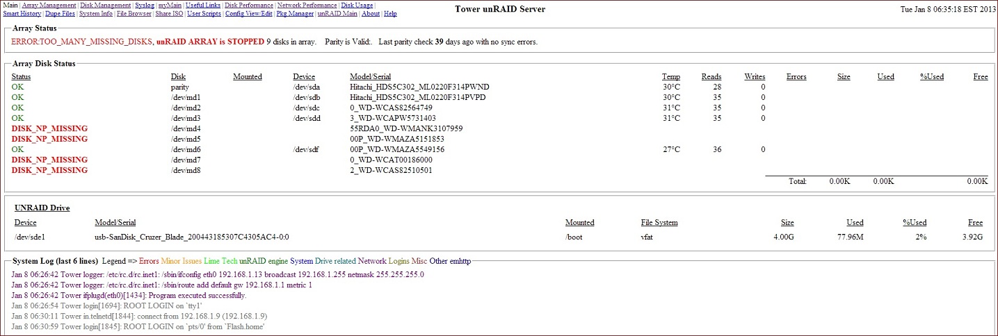

See picture attached. It's up but not running the array due to missing drives.
4 drives missing at one time typically points to a common hardware failure.
(power cable, splitter, disk controller, backplane, power-supply, etc)
Look there for resolution.  Power Down, then re-seat all connections to the backplanes, drive trays, power supply, then reboot.
I took the 3 drives i had in the 2nd icydock and connected them direct to power/sata cables.  System is working now.  Looks like a bad ICYDock.

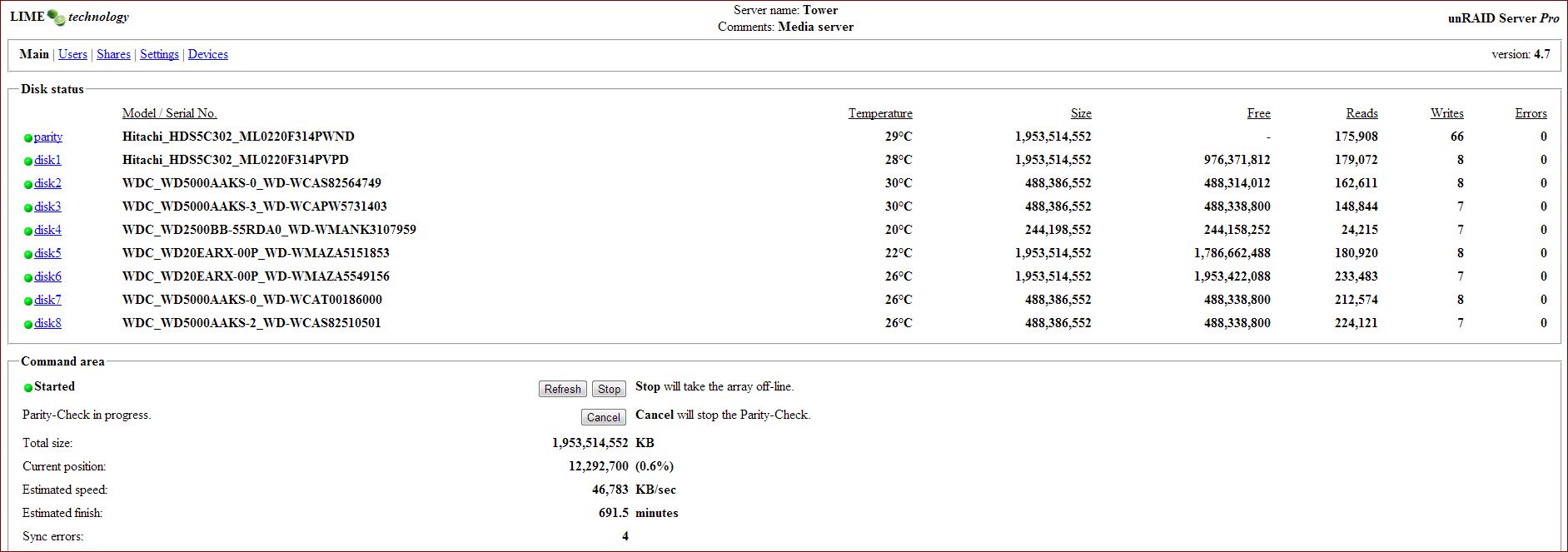

See attached for what is going on now (parity check).
What is the best way for me to shrink my system for now to use only 5 drives in 1 Dock and 1 single IDE drive?
Right now I think i have close to 4 Terrabyte of storage capacity but am not even close to using it (for now).
